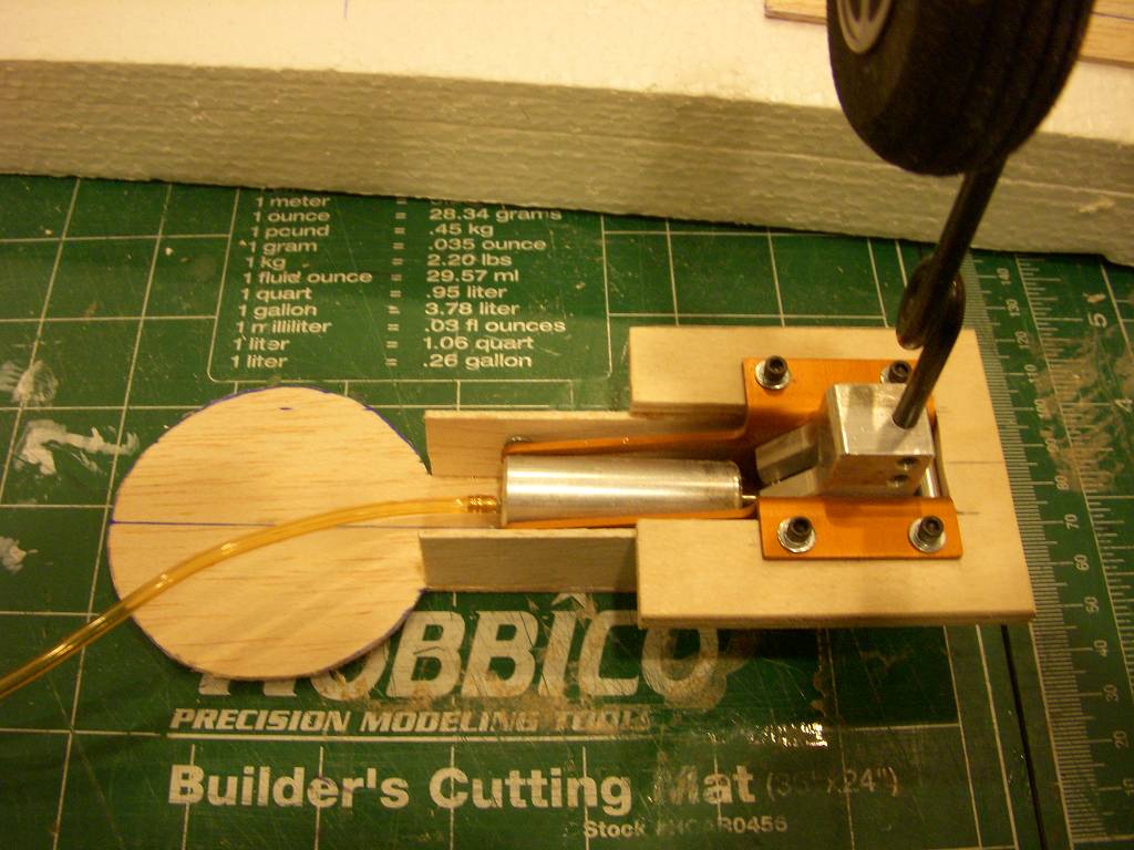

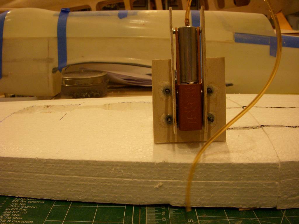

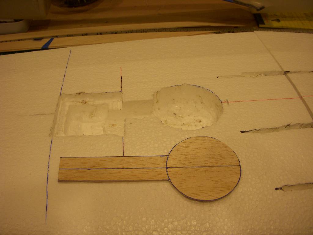

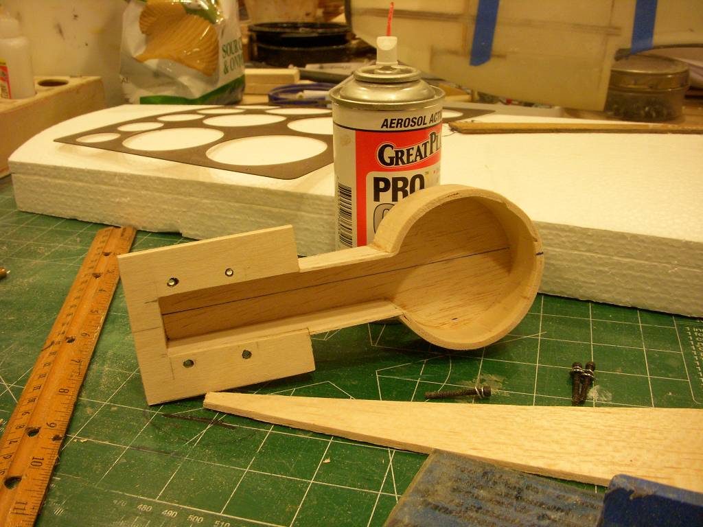

Making the retract gear boxes now and fitting in the gear. I used blind nuts on the back of the 9 ply retract mount plates for 4/40 bolts and used some thick CA to hold them in place.
