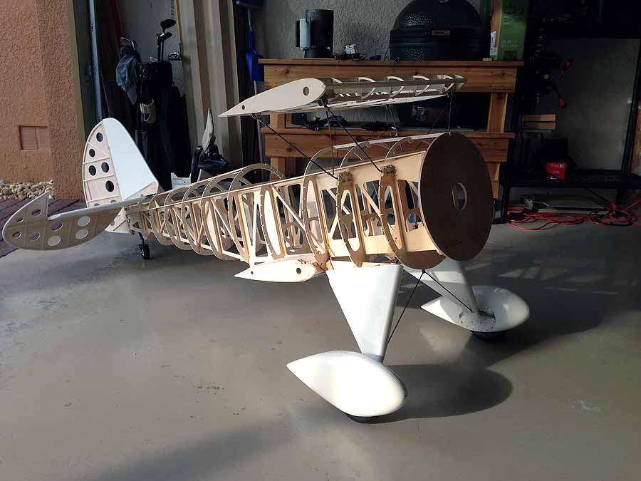

I'm making progress on my Barth third scale Waco. I had to wait for Peter to return from vacation to mount the stab because the manual said "The AoA of the horizontal stabilizer should be 2 degrees (trailing edge up)." He did confirm that it should read "trailing edge down". Any way, the stab/fin are mounted, and are removable as an assembly for ease of transportation. I set it up with each elevator half having its own servo. Tomorrow I start the wings. The kit is pretty complete with many parts, and is well designed.
Chuck
