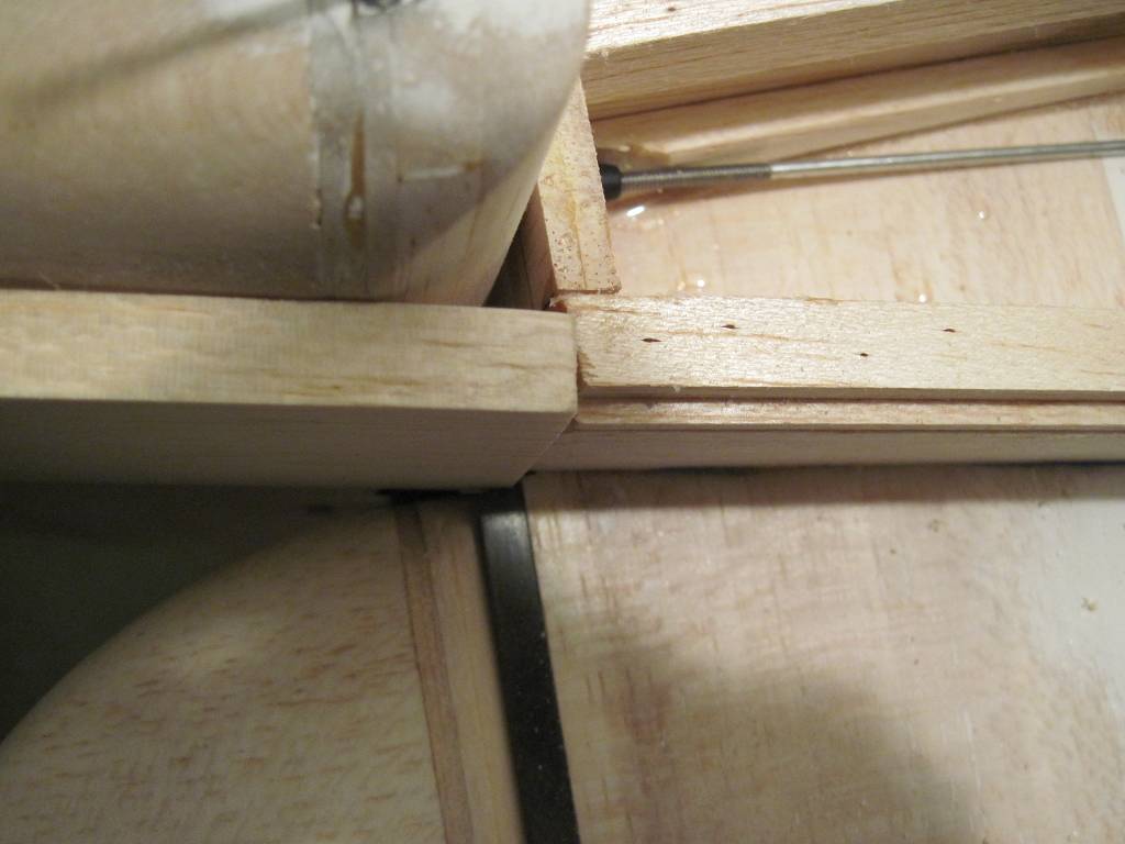

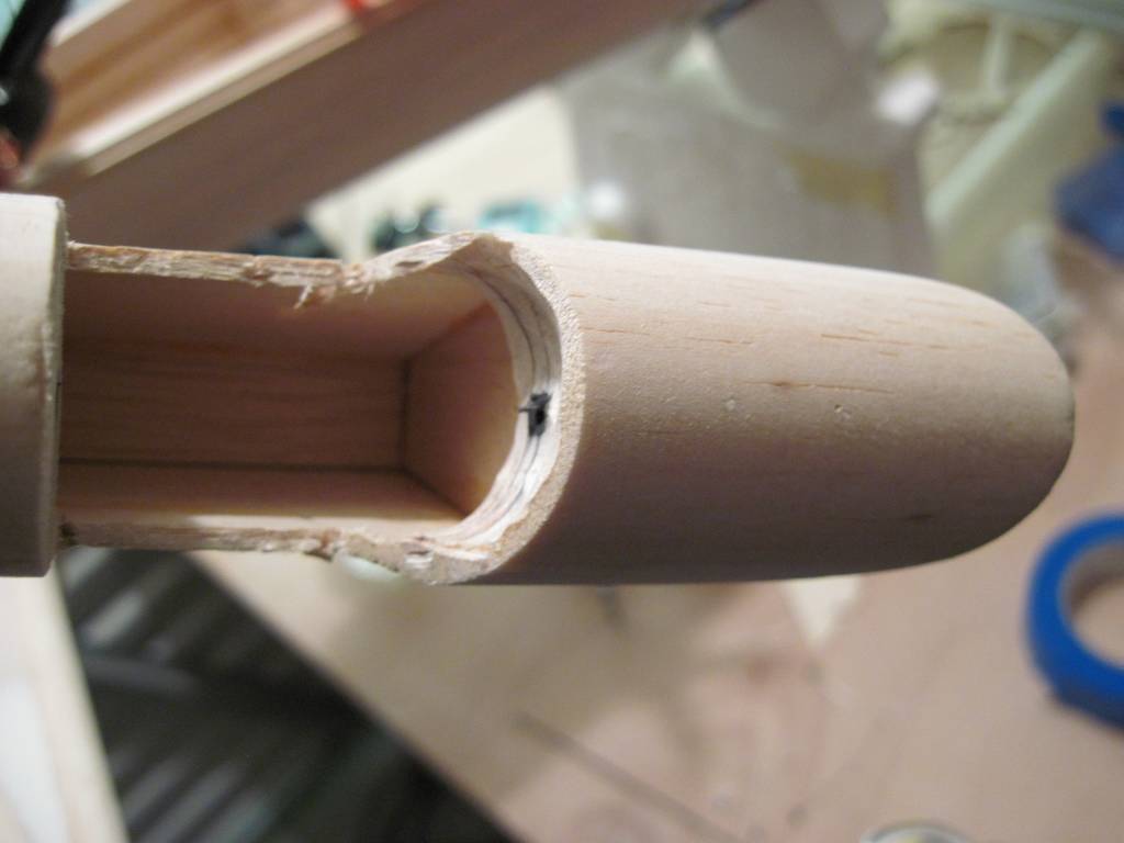

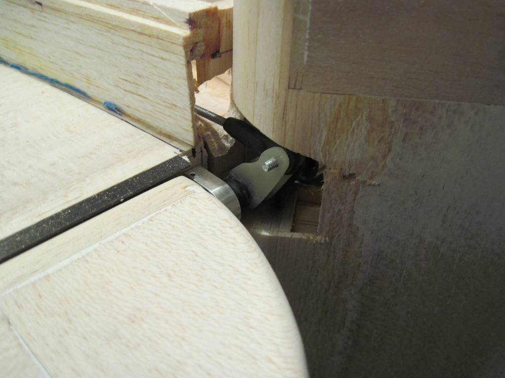

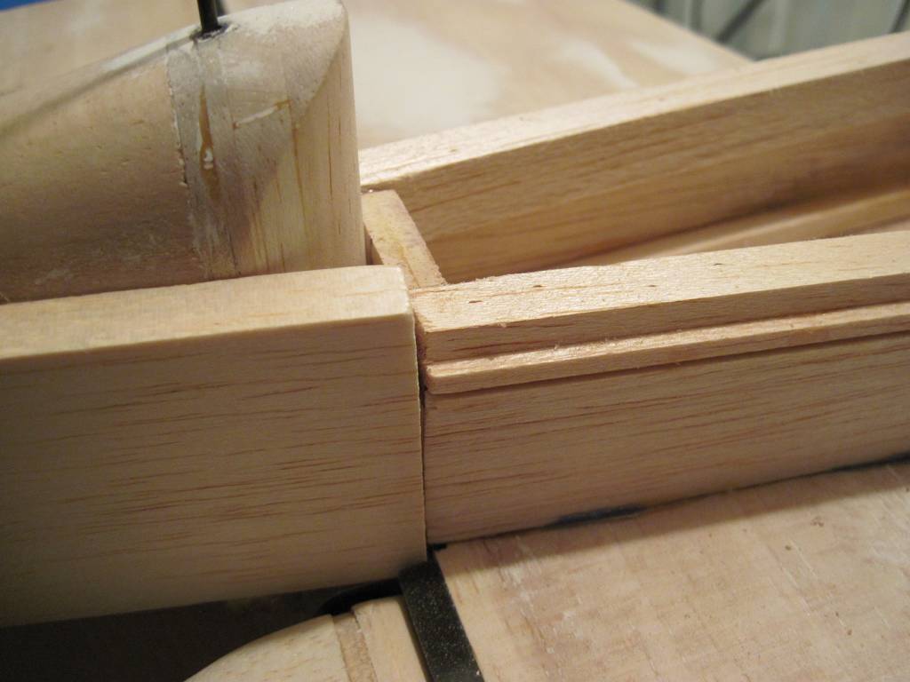

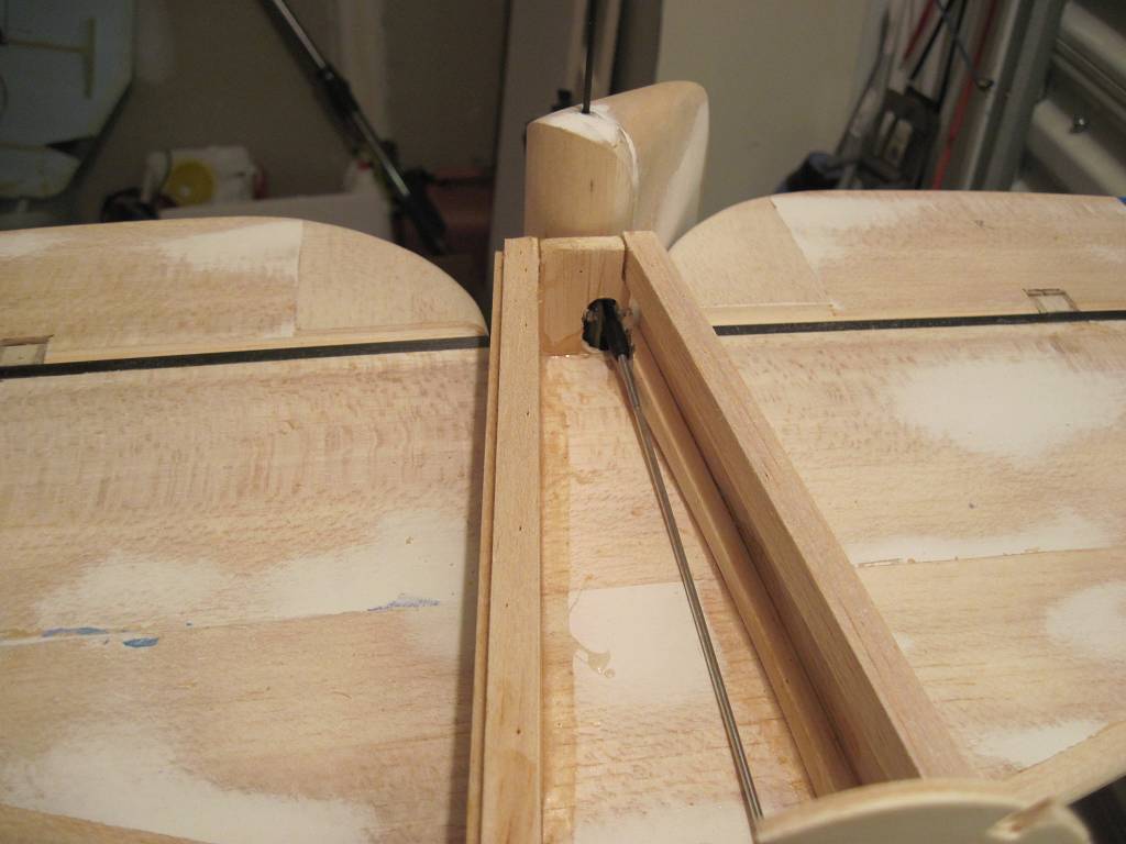

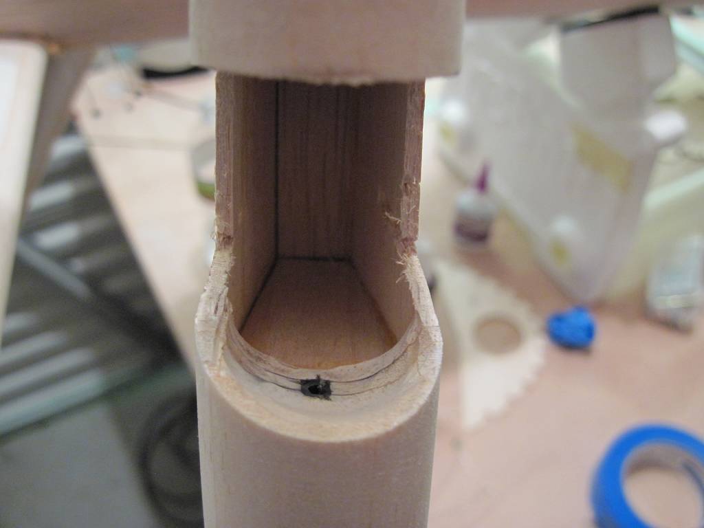

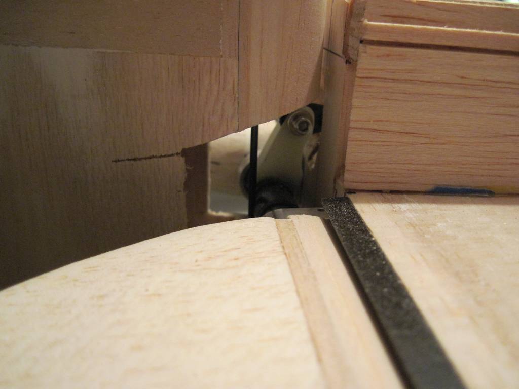

<div style="margin-bottom: 0in">Ruder and Elevator linkages.</div><div style="margin-bottom: 0in">
</div><div style="margin-bottom: 0in">When I framed up the ruder I put in some additional pieces to create the pocket for the elevator arm. I will clean this up and reinforce it as I go. The arm for the pull pull will sit on the bottom former that starts the solid block. That is on tap for tonight. <div style="margin-bottom: 0in">Also I will make the bottom hinge. <div style="margin-bottom: 0in">I will use 3/8 balsa to create the bulge that will match the bottom section of the fuselage. I will cut the radius out of the ruder from the bottom of the pocket just in front of the hinge tube, then glue in a square block and after the bottom of the fuselage is finished I will sand it down to match, and then do the radius again.</div></div></div>
