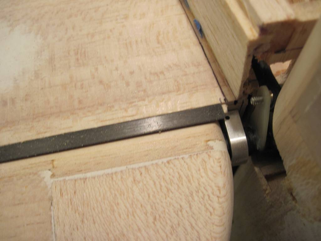

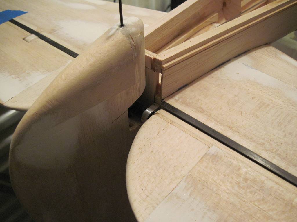

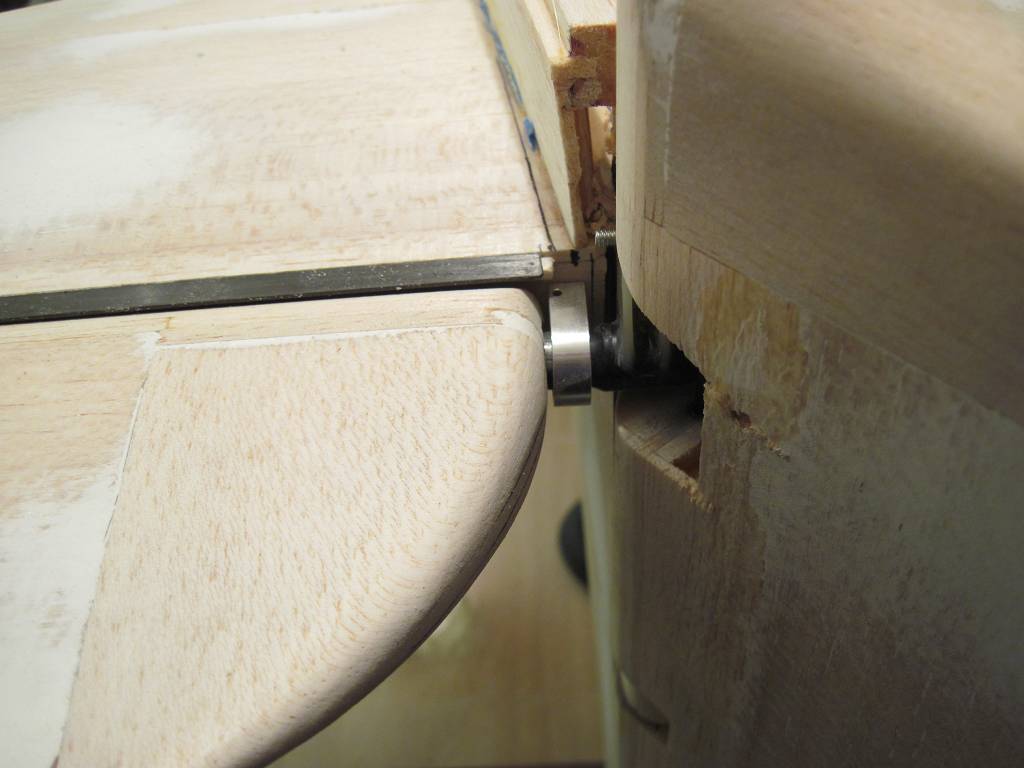

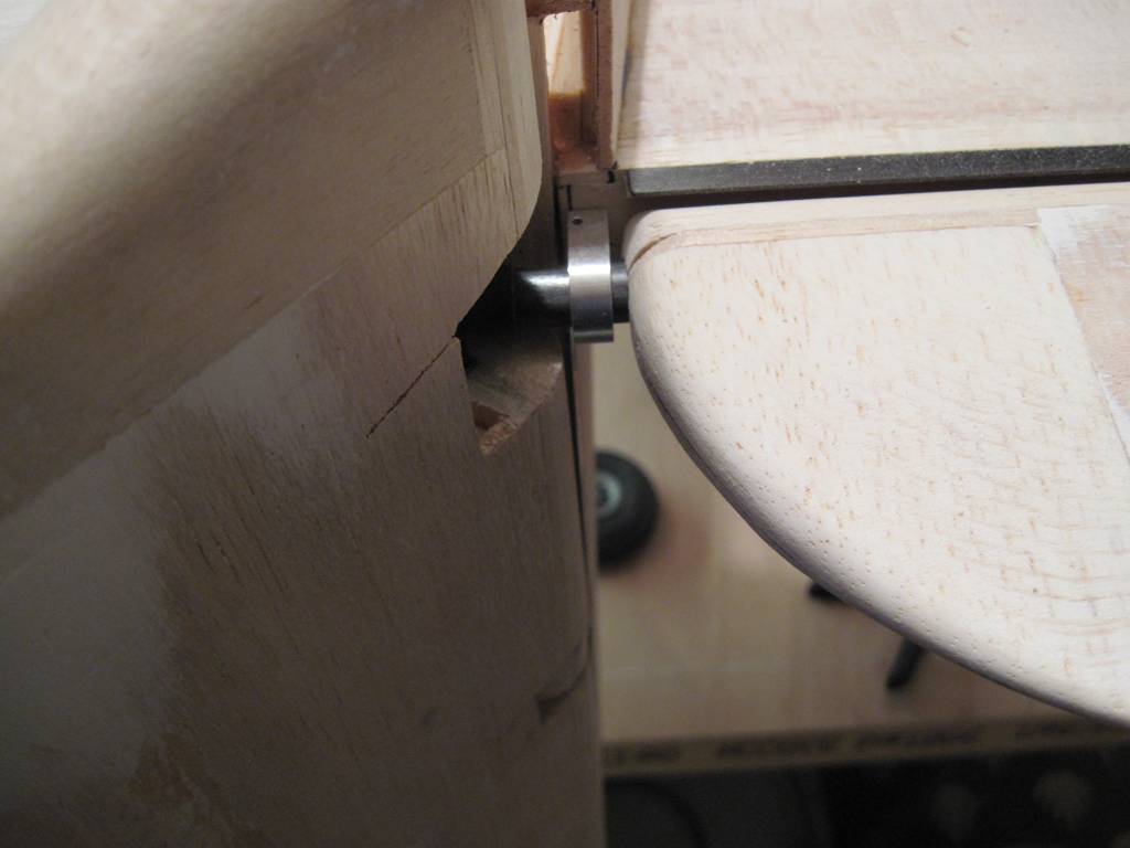

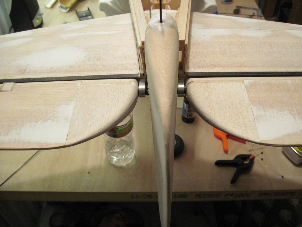

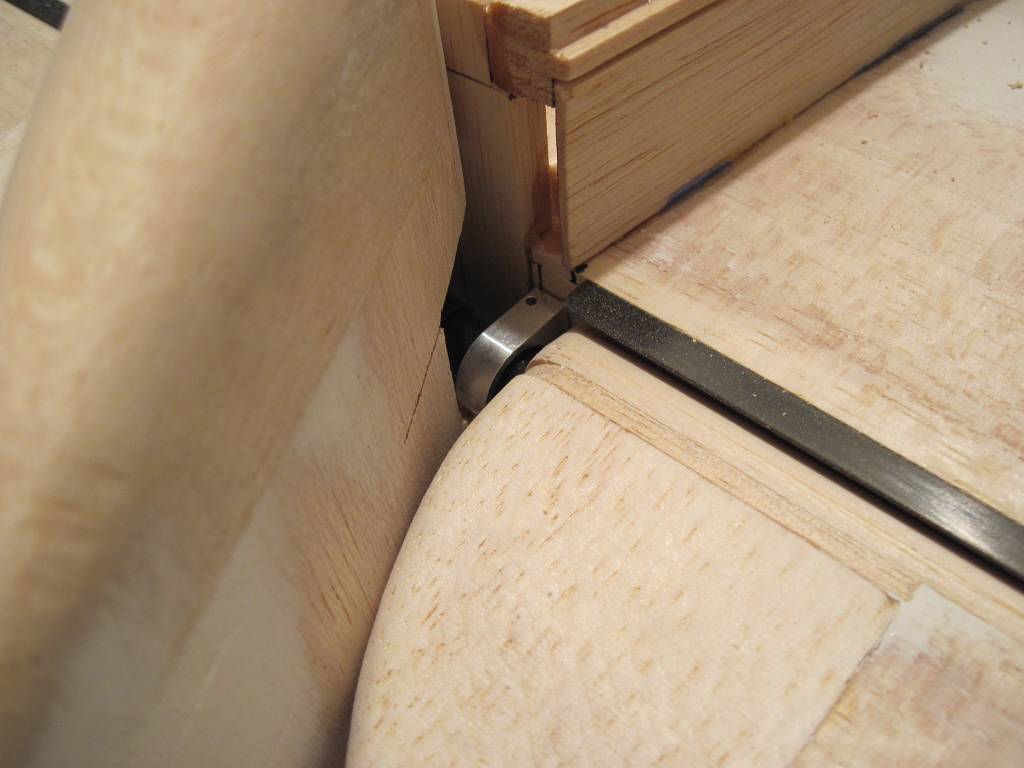

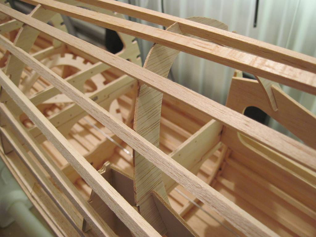

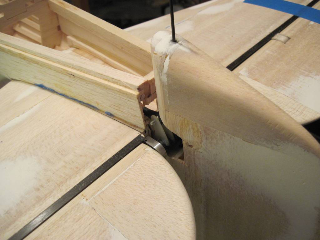

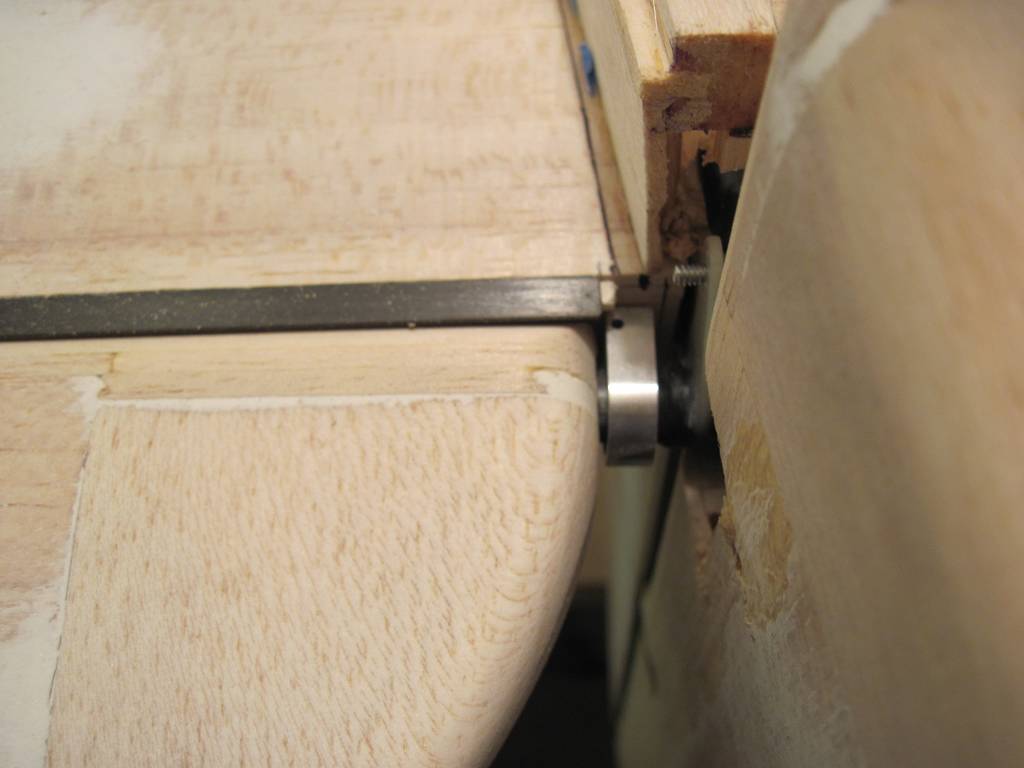

<div style="margin-bottom: 0in">Back to the Ruder</div><div style="margin-bottom: 0in">
</div><div style="margin-bottom: 0in">Everything is all lined up and working great. I am so pleased with the way it is turning out. I do think I will trim about an 1/8&rdquo; of the ends of the elevators before I glue the tube in. Looks like plenty of throw on the ruder.<div style="margin-bottom: 0in">I will measure the throws tonight.Not going to be 3D Edwin <div style="margin-bottom: 0in">Now that I can move the fuselage around and I am not under pressure gluing the stab in I found the discrepancy in the measurements that was giving me fits. On the right side of the bottom stab saddle it is in just a little, maybe an 1/8&rdquo; This is easily fixed as I shape the bottom and I will just add some material to blend that in. You can see the line I drew in. <div style="margin-bottom: 0in">I am test fitting the stringers to see where I need to cut the additional stringers in at 5B I will be adding some hard wood to the original stringers and use the balsa for the additional stringers.</div></div></div></div>
