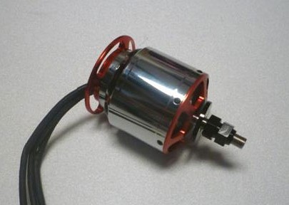

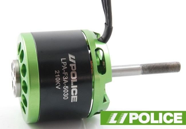

<span style="font-size: small">HOWEVER: If you are going to put a 160-size motor in a 2m plane like the Capiche, then we are basically talking about an <u><span style="font-size: medium">F3A type motor</span></u>.</span>
-F3A motors are usually ~580g and have Kv ~220. They generally have a 5030 stator (some heavier F3A motors have a 5330 or 5335 stator -like Dualsky and Himax, if I remember right ...).
There are a number of relativelyinexpensive F3A motors to consider: I suggest you have a look at:
LiPolice LPA-F3A-5030-210KV, 580g, Kv 210, 7T, 28 pole
OK Hobby Infinite A5030-210 (For F3A), 580g, Kv 210, 7T, 28 pole
Mega Power TAURUS MPA5030-210KV (F3A), 580g, Kv 210, 7T, 28 pole
Turnigy F3A SK3 Competition Series 28 Pole Outrunner, 590g, Kv 240, 6T, 28pole
Torque F3A "Silver Bullet", 580g, Kv 220, 7T, 28 pole (from Extreme Flight, E-F)
Shulman Aviation FURY 60/67-230 "F3A", 590g, Kv 230, 28 pole
<span style="font-size: medium">-It seems really quite unbelievable, but actually ALL theaboveF3A motors (and a few more ..) are made together in the Sunray Tech factory, side-by-side along with Hacker and Torque motors etc:
</span>
More on F3A motors, tomorrow ...
pics show: 1,2,3: LiPolice, OK Infinite and Megapower F3A motors; 4, Shulman FURY F3A motor; 5,6, Torque F3ASilver Bullet motor
