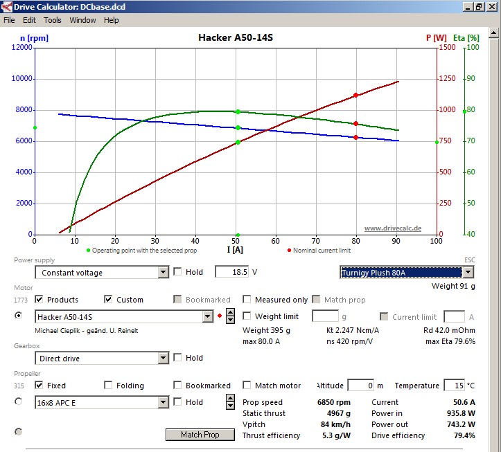

ORIGINAL: rosnikI'm looking for cheaper motor than Hacker ...butfor 16x8 and 5S ... and with same power
So you want a cheaper motor than Hacker, you want to use 5S LiPo, and you want to use a 16x8 prop. And you want the same power and thrust, using 4000mAh LiPo packs, as you have with the Hacker A50-14 S motor.</p>
-Just to understand the situation a little better, and to look at what might be the best Kv for a motor, I did some simulations using DriveCalc.
a: The first shows your present situation -using Hacker A50-14 S motor (Kv 424), with 16x8 prop, and 5S LiPo.
As you can see from pic 1 below, this produces:
50.6A; 935.8W (input power, not power produced by motor ..); prop RPM 6850; thrust 4.97kg;</p>

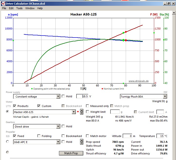

b: So what happens if we use a motor with a higher Kv -like Hacker A50-12 S (Kv 492), with same 16x8 prop and same 5S LiPo ? This is shown in pic 2. This produces:
78.3A; 1449W; prop RPM 7865; Thrust 6.8kg;
-Prop RPM is higher, because motor has a higher Kv; This higher RPM produces an extra 1.83 kg of thrust. Pitch speed is higher (96km/h) so the plane will have a higher top speed.
BUT: current draw is much higher, at 78.3A; The max current for this 12S motor is 70A -so this large current of 78A may damage the motor, especially if flowing through the motor for long periods.</p>
