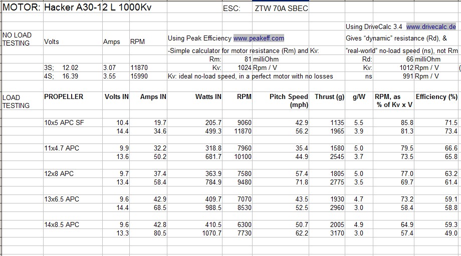

I have tested on my Motor Thrust Stand: HACKER A10-9 L vs TURNIGY SK3 2122-1570Kv vs GENS ACE 2122-1580Kv
-<span style="font-size: small">They gave TOTALLY identical results</span>, with currents for each prop almost identical, and thrust within 10g of each other ...
-It is clear that they are underneath, the very same motor ...</p>
I have also tested on my Motor Thrust Stand: HACKER A20-22 L, 924Kv vs TURNIGY SK3 2830-920Kv vs GENS ACE 2726-960Kv
-<span style="font-size: small">They gave TOTALLY identical results</span>, with currents almost identical, thrust within a few g of each other ...
The motors are indistinguishable ... -They are exactly the same motor ..</p>
I have also just tested (yesterday) on my Motor Thrust Stand: HACKER A30-12 L 1000Kv vs TURNIGY SK3 3542-1000kv
-<span style="font-size: small">These motors also gave TOTALLY identical results, </span>with currents almost identical for each prop, and thrust for each prop very similar indeed...
(See attached PRELIMINARY data sheets for these 2 motors)
<span style="font-size: small">I JUST COULD NOT BELIEVE IT -THEY WERE SO SPOOKILY, INCREDIBLY CLOSE ...
THEY ARE SO VERY VERY OBVIOUSLY -EXACTLY THE SAME MOTOR ...</span><span style="font-size: medium">
</span> -They just have different clothes on (i.e. a slightly different outer case), but underneath the outer clothes, they are totally IDENTICAL
And their performance is also TOTALLY AND ABSOLUTELY IDENTICAL -even down to the current generated,and thrust produced ...
<span style="font-size: small">They are exactly the same motor -There is just no doubt about it, at all ...

<span style="font-size: small"><span style="font-size: x-small">Pics show: 1, Preliminary test results for TURNIGY SK3 3542-1000kv; 2, Preliminary test results for HACKER A30-12 L 1000Kv
-These 2 motors are almost identical -Indeed, it could be results fromtwo different Hacker A30-12 L motors-they are that close ...
-Please note these results are very recent -and more tests will be done, with different and larger props ...
see:http://www.rcuniverse.com/forum/fb.asp?m=11463161 for details of Motor Thrust Test Stand used</span></span></p>
