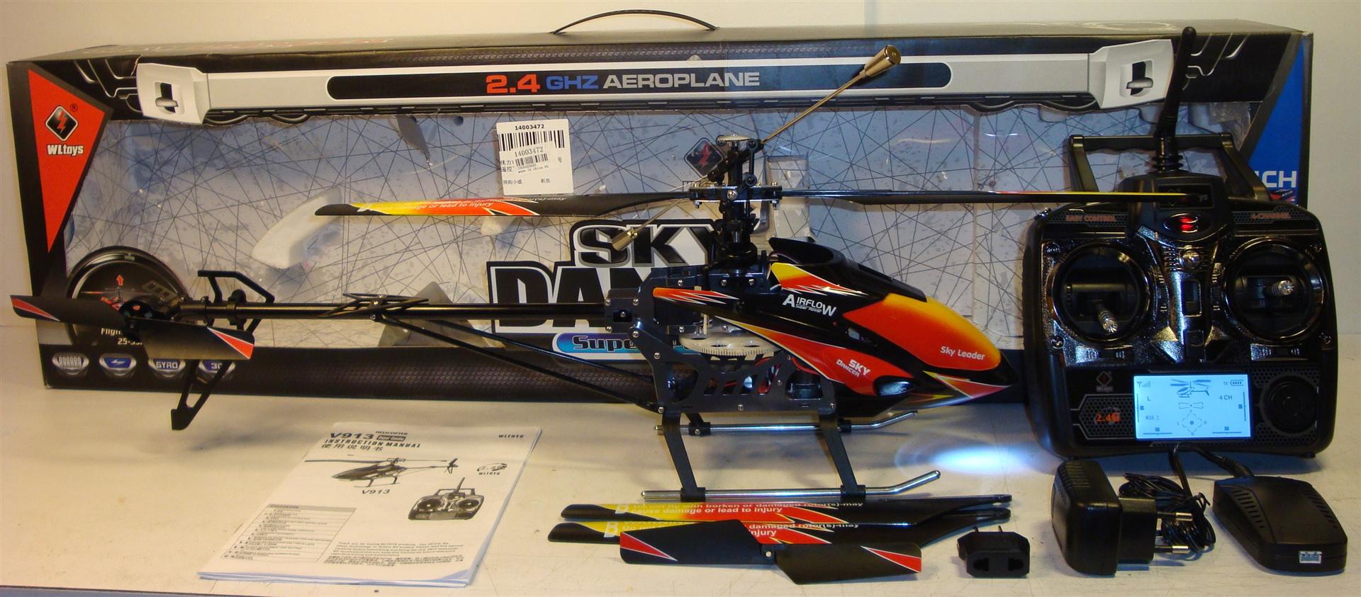

Included in the kit were:
V913 Helicopter with 1500MAh 7.4V LiPo Battery Installed
Transmitter (Uses 4 AA batteries; Not Included)
Pair of Spare Main Blades
Spare Tail Rotor
Charger for Battery in Helicopter
AC Power Pack for LiPo Charger
USA to EuroPlug AC Adapter for AC Power Pack
Manual written in Chinese and the now-familiar Chinglish dialect

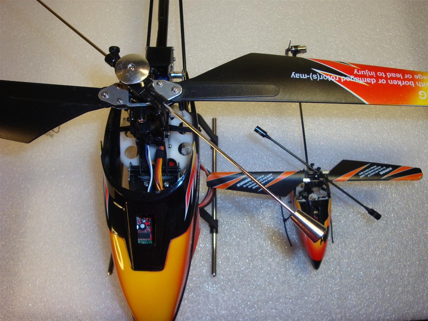

The V913 is larger still; approximately 400 sized, and the blades are exactly the same as those on my DH 9118 even down to the molding marks. Man, do they move some air! I fear the day they make a 700-size model; it will probably be brushless powered and sound like a turbocharged pterodactyl swooping down on its prey.
I don't know if this collaboration is the result of a business agreement or a business acquisition; but it does suggest that a lot more exciting products are on the horizon for both companies! WL Toys has been pushing the envelope, blurring the lines between Toy Grade and Hobby Grade helis since the first little Corter V911s, then the V9x9 Quads and V922 CP Flybarless MicroHeli; adding the larger scale manufacturing prowess of Shuang Ma could mean many more affordable and larger models for us to enjoy in the future!
I do all my own stunts!
This heli, aside from the obvious Shuang Ma influence, is another (and mostly successful) attempt to take the brilliant performance of the V911 and upscale it to the larger heli market. It's still a "Toy" helicopter, so performance is not going to be the same as "Hobby" grade helicopters; then again, neither is the price.

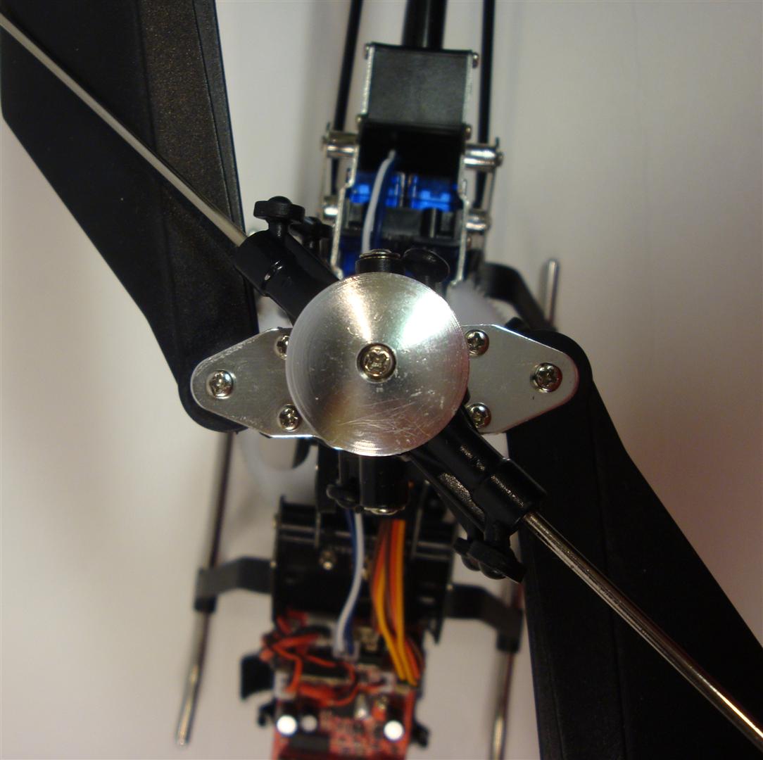

Motor is still mounted fore of the mainshaft to help keep rotational mass balanced; the head uses the same 45&deg; offset flybar, only with the servos moved aft of the mainshaft instead of built into the mainboard.
Main blades now pivot like a real heli as opposed to the V911's single solid "propeller". This thing is big &amp; heavy enough that it would be dangerous if they didn't!

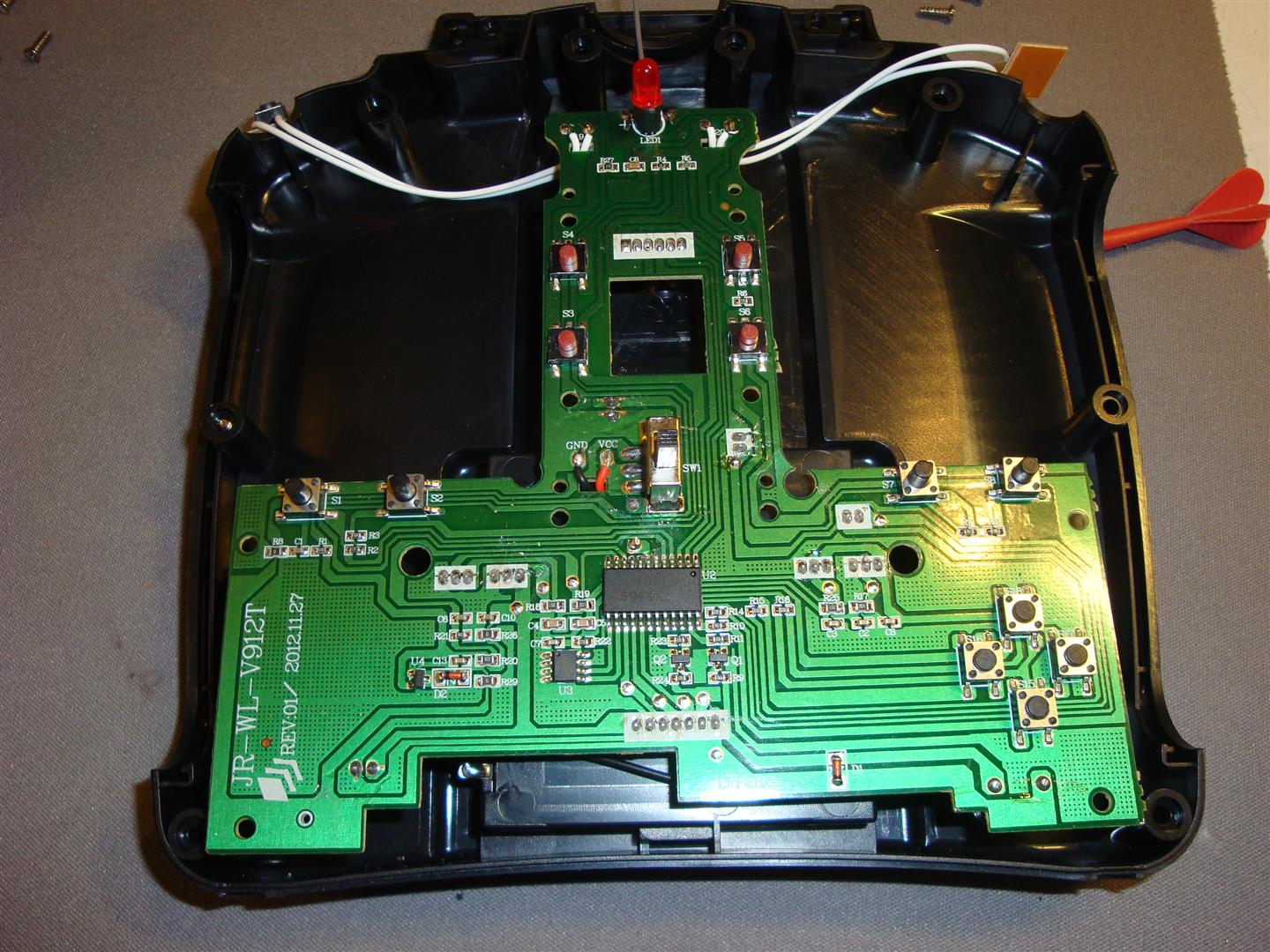

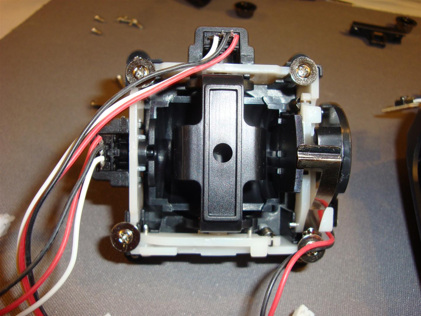

The other front panel buttons are presumed to provide other functions on as-yet unreleased models; though they ARE populated with active switches and circuitry.
Inside, they've replaced the "all on one PC Board" design with a more "Real Radio" design which features actual, separate gimbals and digital trims.
