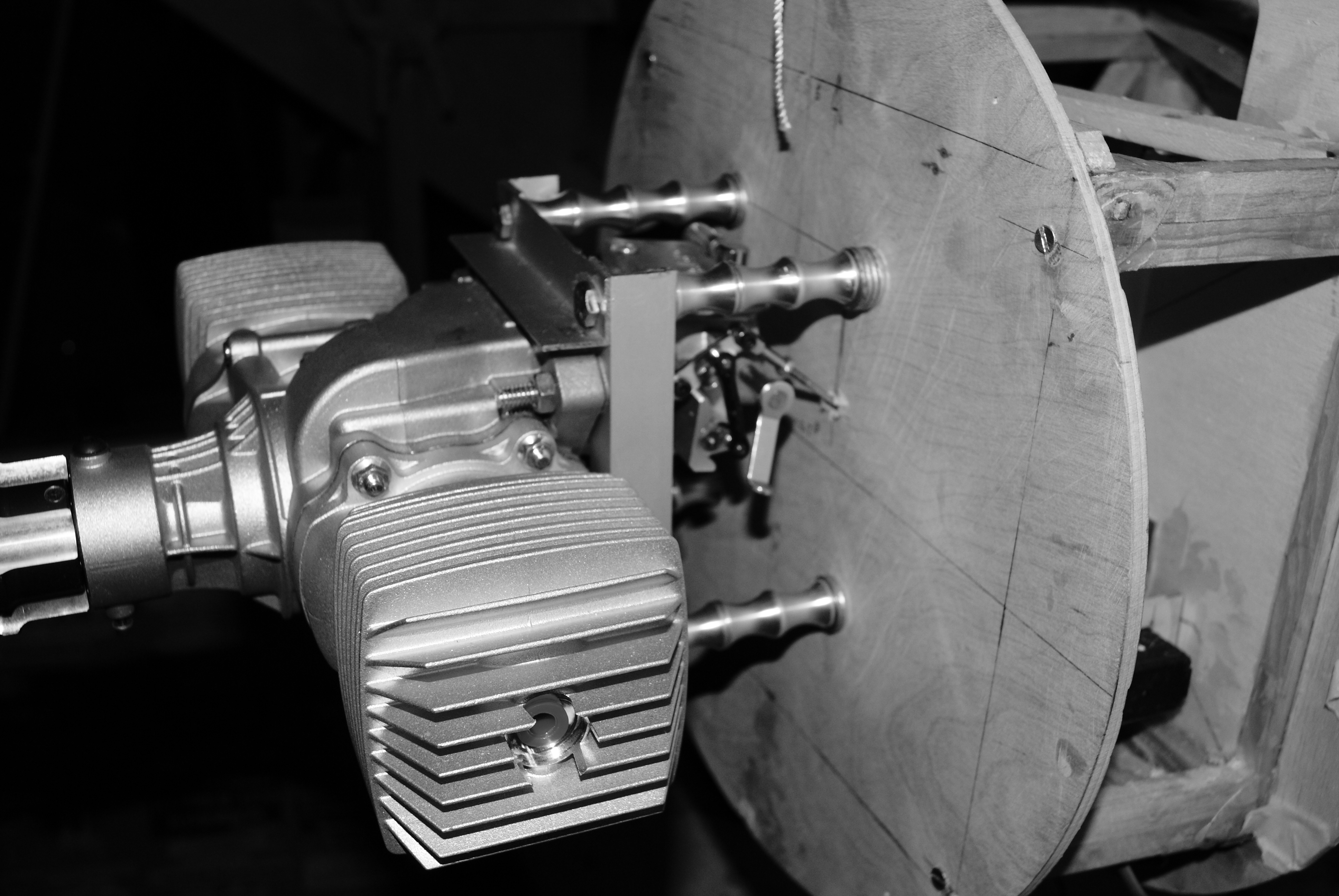

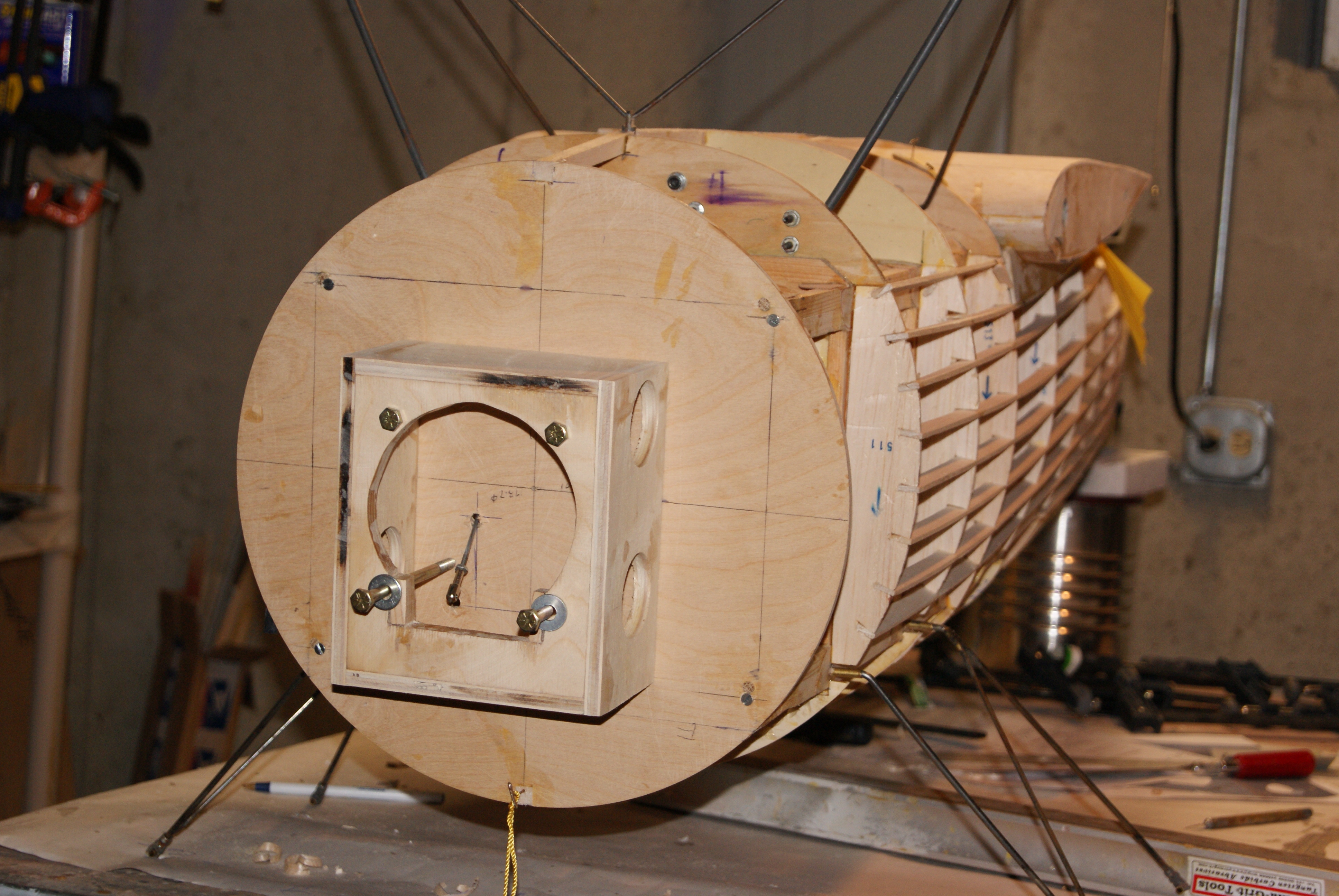

WacoNut,
I took your advice and pitched the standoff design in favor of wood box. Agree, much stiffer. Will put down and side thrust angles on back side of box. Can epoxy box on to firewall and bolt thru as well. Next question on firewall. Looks like it could use more to make sure it stays on.
Mike H
