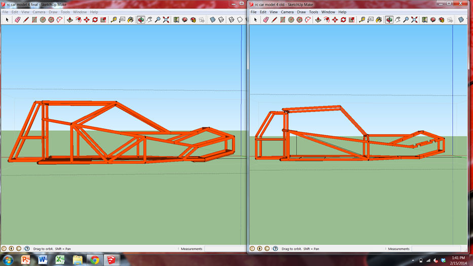

Quick update: I have looked at my mock up and decided on the reinforcements to make the chassis more rigid: on the left is the new chassis and on the right is the old one. (I used Google Sketchup)
I updated the cad model on the:
  • rear shock tower was quite flimsy before
  • front shock tower/suspension mounting points were fine, but needed lateral reinforcement
  • roof bent at the joint and added no stiffness to the chassis
  • where the side of the chassis attached to the rear shock tower.
