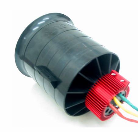

The EDF CS XRP 90mm 14 blade provide from Turnines-rc (
http://www.turbines-rc.com/fr
) is good fan. I try it in static. The battery is Turnigy Nanotech 5000mah 35-70C used 10 times. The measurements of ampere and thrust are 94 ampere to 22,1v 2100 watt and about 2.9 kg. But the absorption and the thrust are subject to variations due to the quality of the batteries used. To control this fan with a good margin then you still need a regulator 120ampere. Good performance for a model that should be able to weigh in order to fly under 3kg. These is a link of the EDF set used (
