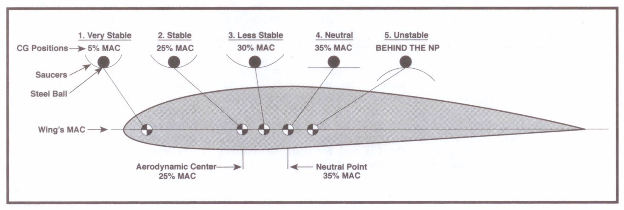

The more you move the CG AFT the more sensitive in Pitch. All aerobatic planes are set up with the CG 32-33% of the MAC or more. 28-30% will give you a nice steady predictable model.
You are correct, Sir!
Since I do not have permission to post excerpts from Andy Lennon's book, "Basics of R/C Model Aircraft Design" (subtitle: "Practical Techniques For Building Better Models"), I can post Andy's credentials, and that he covers C.G. location and its effects in Chapter 6 - "CG Location and the Balancing Act", page 27. Andy includes a diagram (which can be found in numerous places in both print reference and on the 'Net) which shows the longitudinal stability of C.G. location - which I will post (see pic of airfoil profile).
The pic of the airfoil profile shows the longitudinal (pitch) effects predicated on C.G. location. It's pretty simple. The analogy of a steel ball placed in a saucer is used to give a graphic association to longitudinal stability. The more forward the C.G., the more stable the steel ball in the saucer. The more aft C.G., the more unstable. There's no room for argument - again - none. Andy is merely relying on his education:

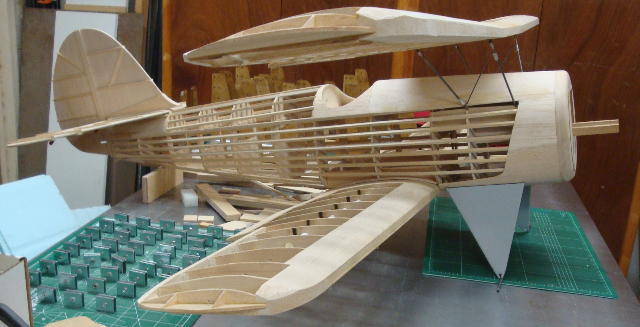

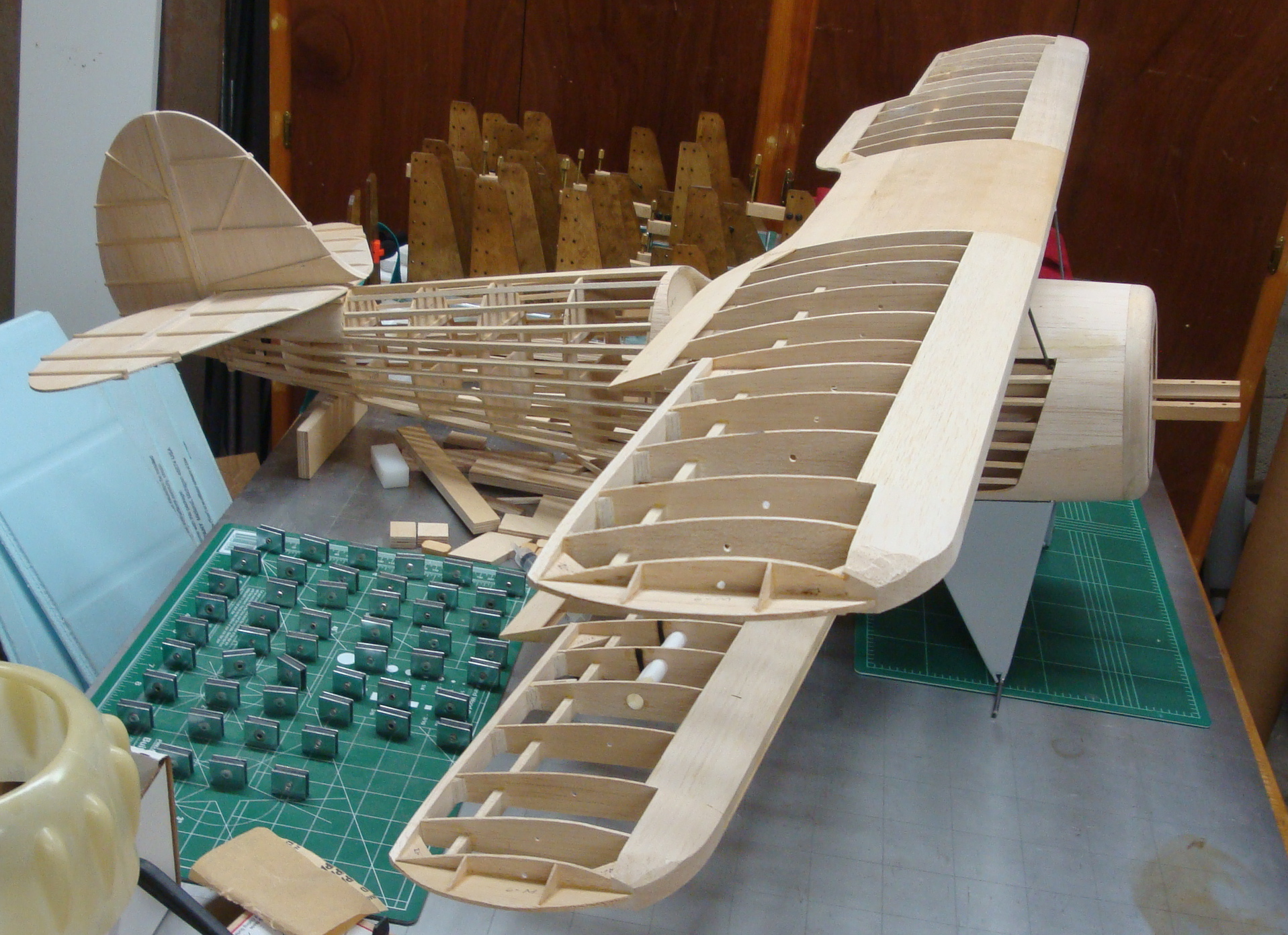

I have been along-time lurker of this thread. I have an older Dave Platt YMF-3 kit framed-up and almost ready to cover:
Build thread: http://www.rcgroups.com/forums/showt...1806391&page=9
My build starts at post #124 - for those that have access. Couple of pics of it in "rough" bones included in this post.
