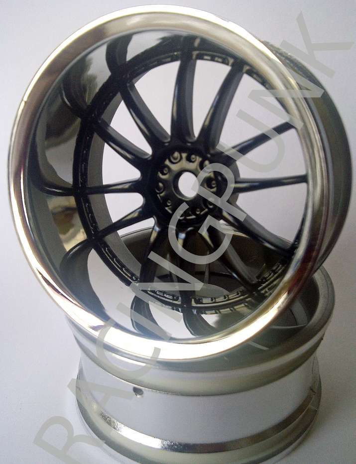

Ahh what you're referring too is wheel offset, any 17mm rim will fit, but how much the wheel sticks out, or if its closer to the car, like these rims, the hub will connect closer to the back of the rim, and will cause the rim to stick out more, or you can have the hub connect close to the front of the rim and have the rim recessed into the body slightly. thats what they mean by deeper, but anything with a 17mm hex size should fit.

Thanks also for clearing up the offset.
