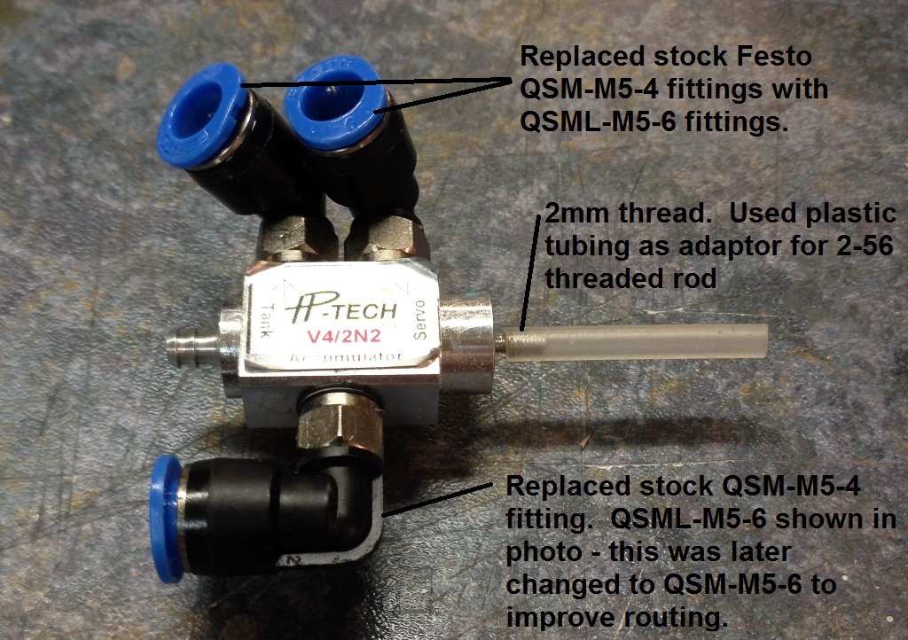

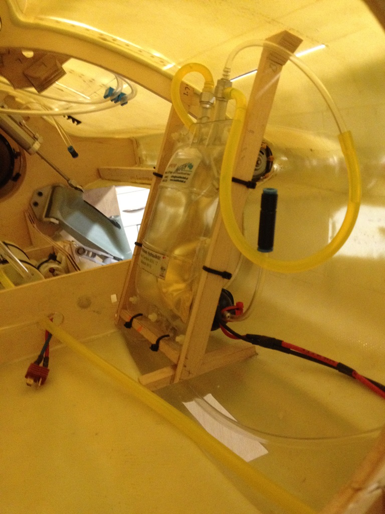

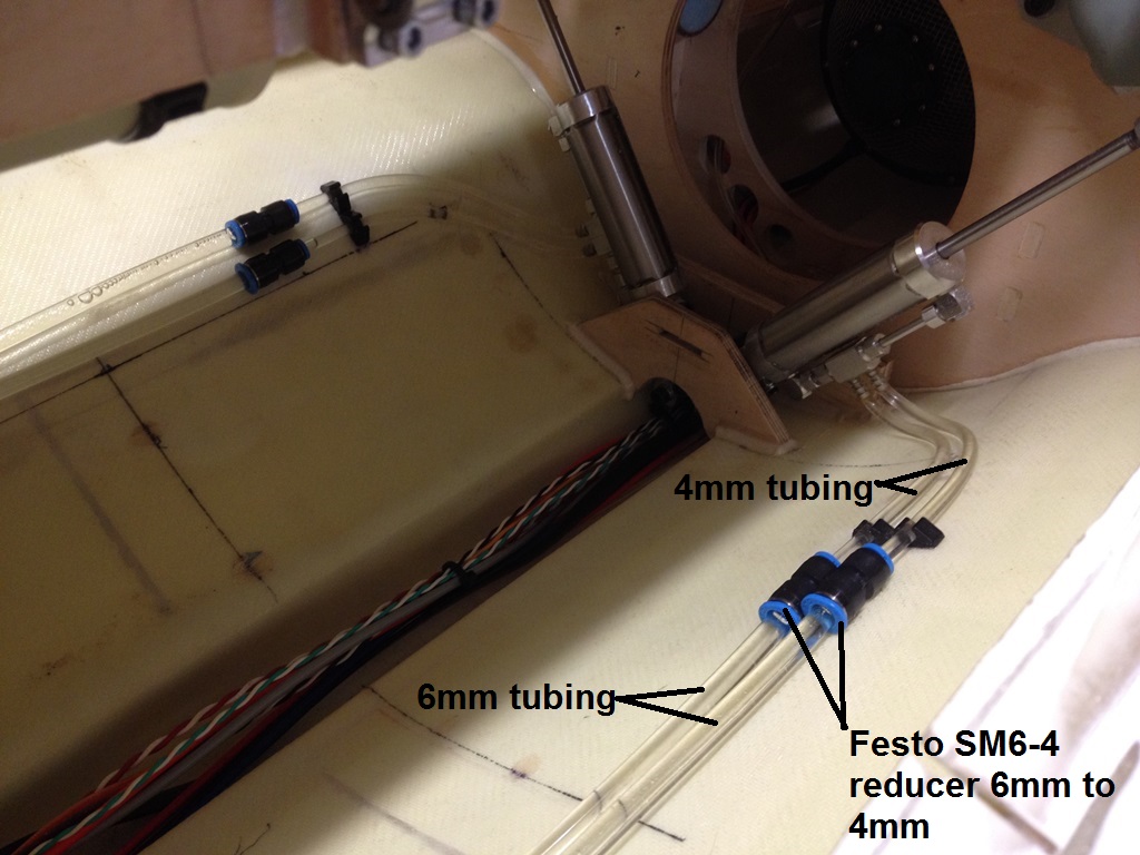

Hydraulic Landing Gear System - Continued
Here are some pics of the hydraulic system installation.
Regards,
Jim
