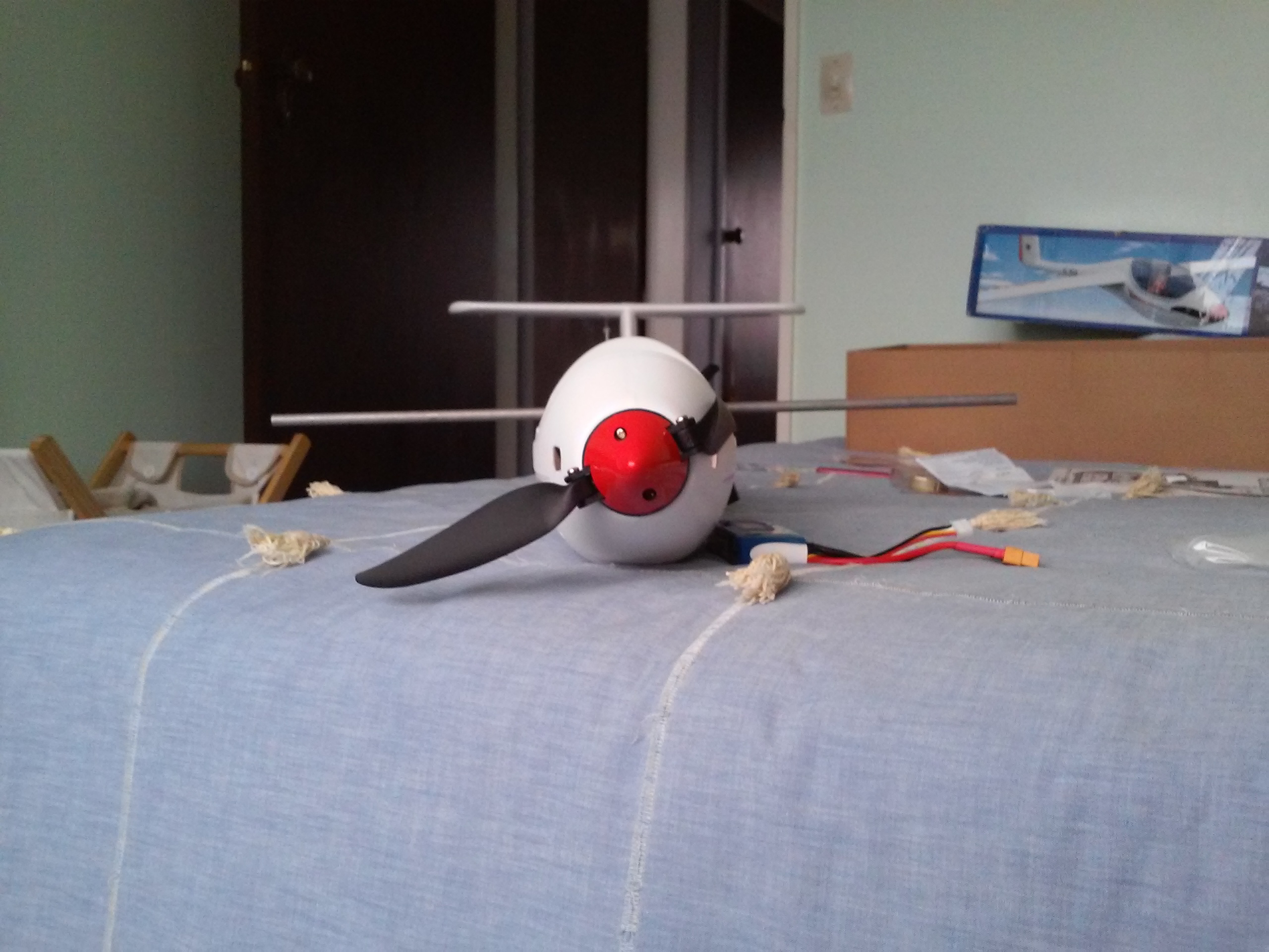

Hi, I have a Lanyu (company now called Volantex) ASW28 that I just bought in New Zealand from a local hobby shop. It's a foamie but looks nice & flies well. There are some Youtube vids of it flying in NZ from some other Kiwi guy: https://www.youtube.com/watch?v=EDUVn26cazs (note the Kiwi accent!)
Cost was an attractive drawcard as I got it for approx NZD$300, not bad for a full-house glider.
However, the kit is a bit wonky in some respects and needs modifying if you are going to use a full-house control setup so below are some pics & a few things I did to mine, which at this point in time hasn't had its maiden flight.
Firstly, the T-tail fin is a bit skew-wiff, so I will have to put a little packing under it to compensate:

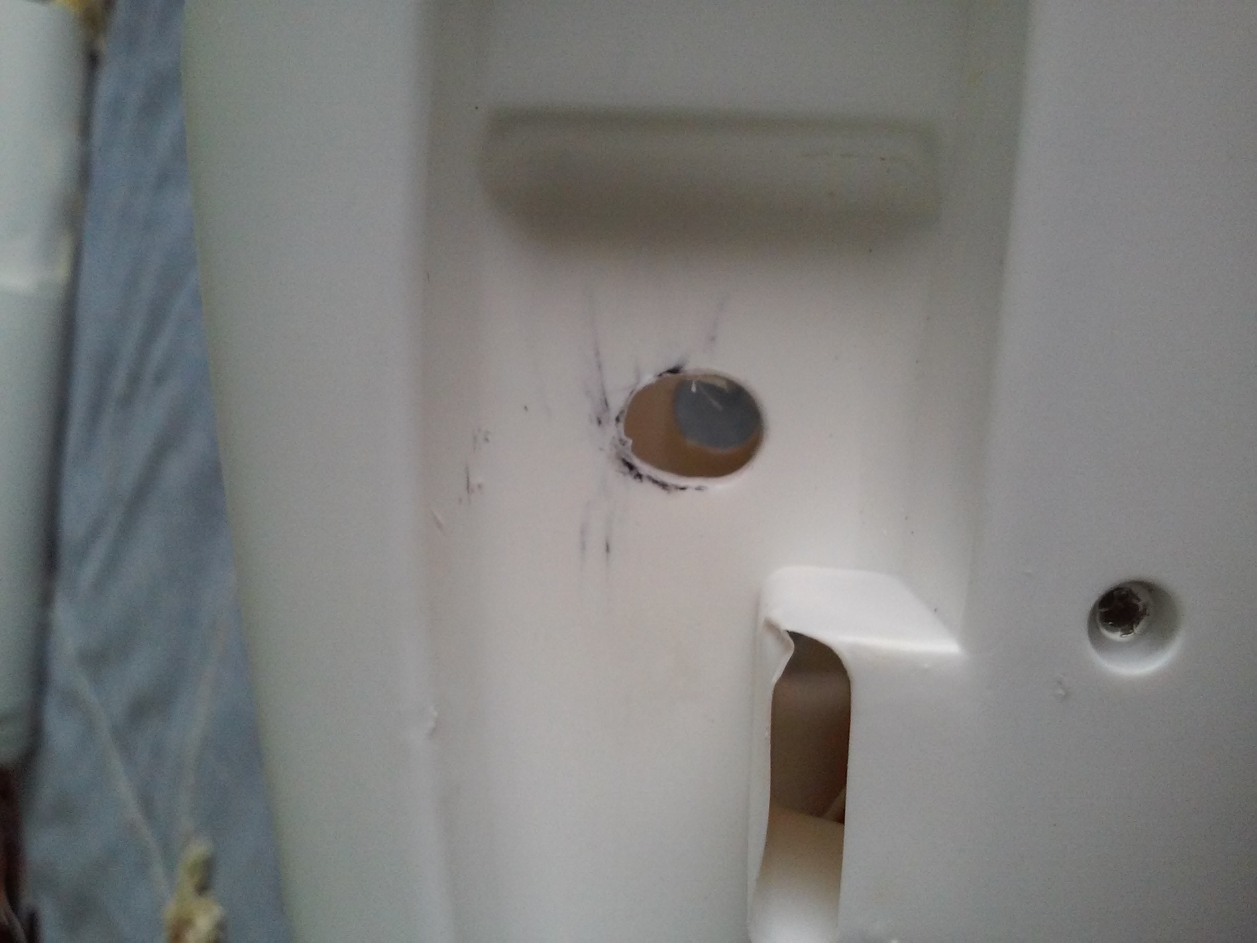

Secondly, I had to enlarge the hole for the metal wing joiner in the plastic fuselage to allow the polystyrene wings to mate into the fuselage:
