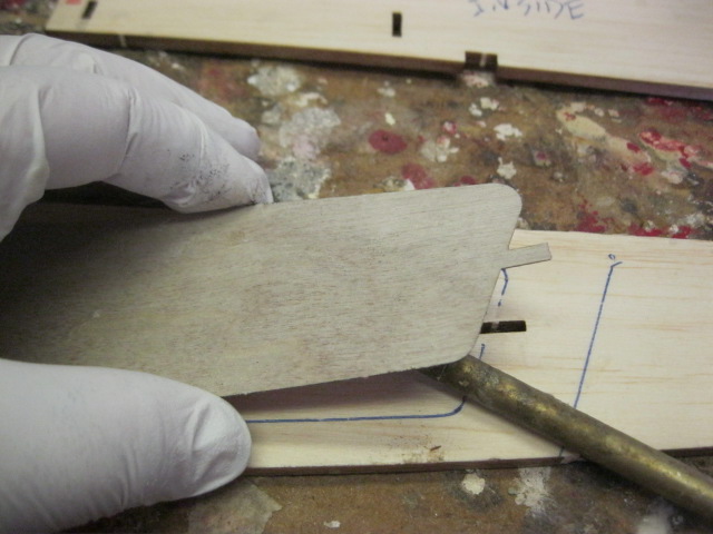

Plywood doublers are attached with 3M-77 adhesive. The doublers have lightening holes. They initially covered the surface and kept the adhesive away.
Spray both sides, wait at least 30 seconds, and join surfaces.
