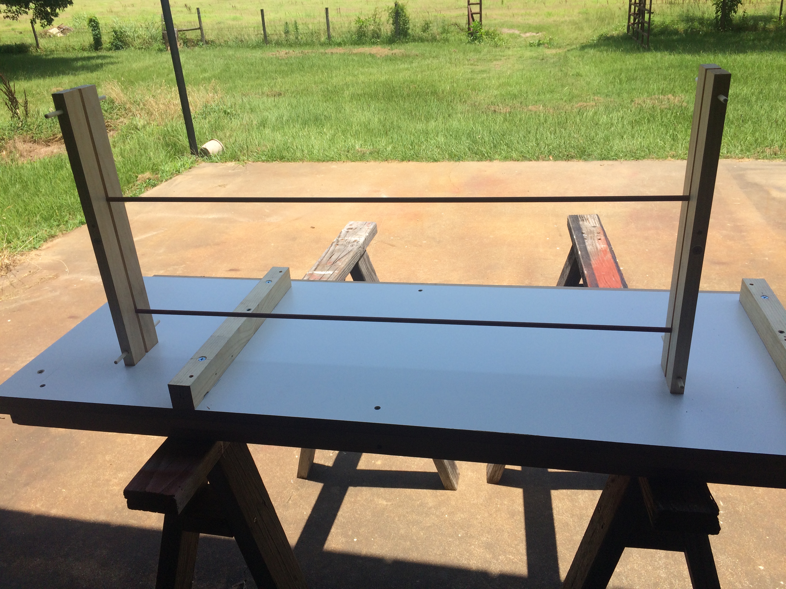

Part Two is done. I made my 2 piece rod holders. All the holes were drilled so the holders will fit either side and install right side up or up side down. The dowels are used for alignment.This will make it easy to flip the jig to work on the opposite side. It may even be usable in the vertical axis. In the pictures the empty hole is for the main hold own bolt which secures the jig to the support blocks. Anyway this is all thought and theory. The real test will be practical use which will happen in a few days.
