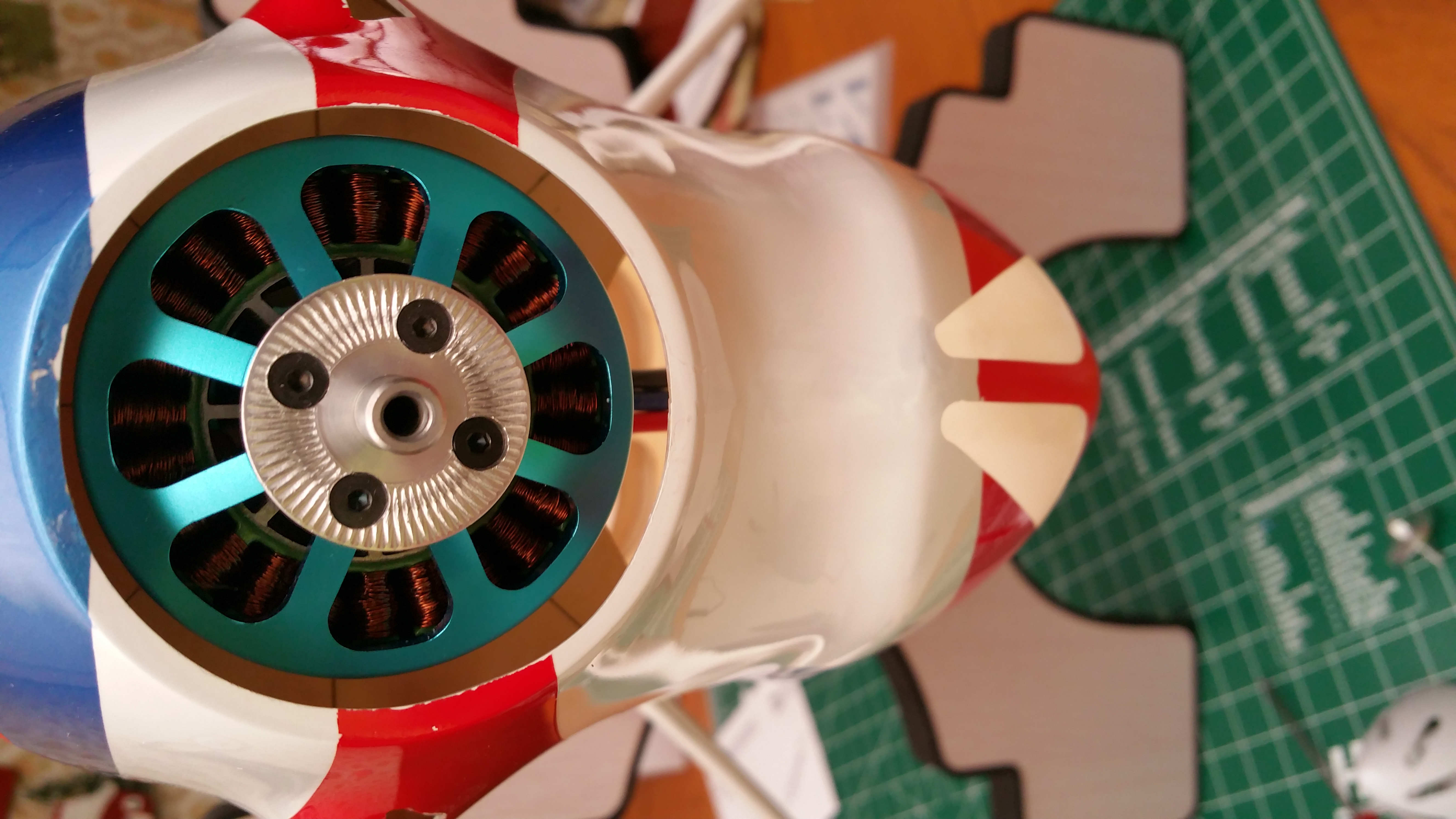

I'm rear mounting a Himax in my E'tube and used the included ply pieces. The nose ring will need to be opened up to allow motor removal. Kit also comes with ply pieces to front mount if you choose. I tried both options before gluing and decided rear mount was best for motor cooling.
Jim
