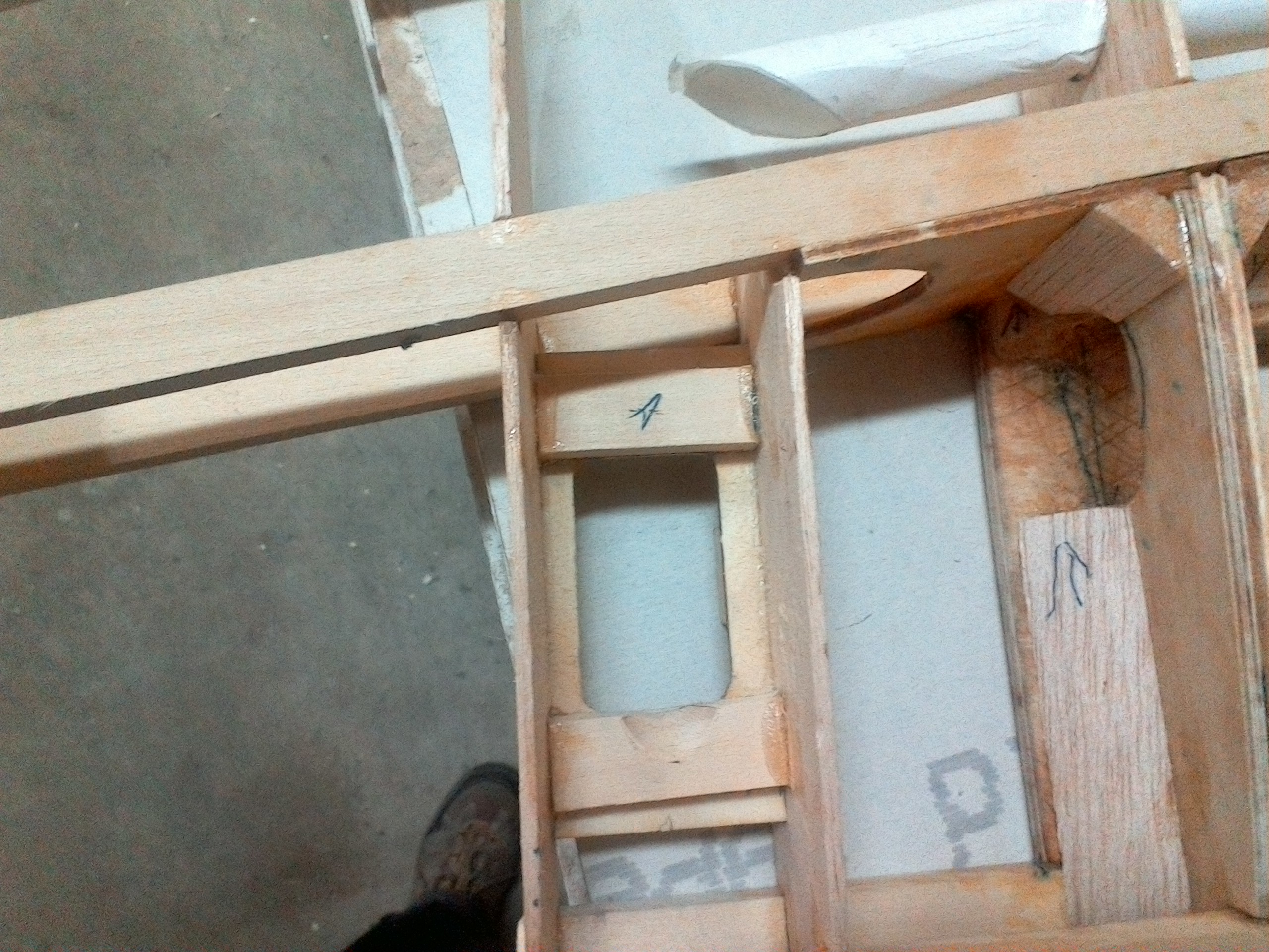

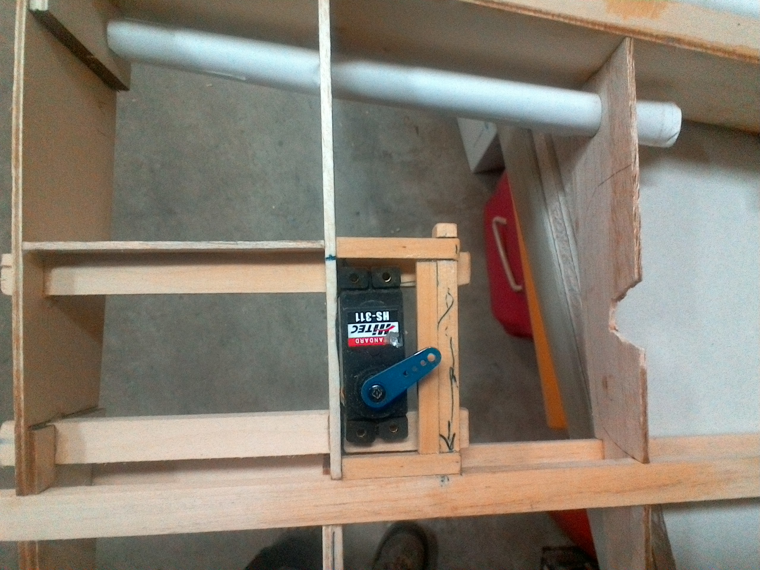

I've been working on the small details on the wing and giving myself a few days to go over the wing drawings to make sure I'm not forgetting the small things.like the servo boxes, they're not mention on the instructions or the plans, it's something that the builder has to come up with, of how he wants it detail ( just a hole, cover, no cover, servo sticking out or not ) it takes time to think of the final product and base on the image the builder can decide how to proceed with the final looks of the part, in this case the servo mounting hole.
I'm ready to start sheeting the wings but before that again, I've been looking at the flaps and ailerons drawings to make sure that everything is in place and how I will proceed with the sheeting.
The servos mounts on the wing are going to have a frame and the servo will be covered by a 1/32 ply lid with a hole for the servo gear to stick out, only the servo arm will be visible.
