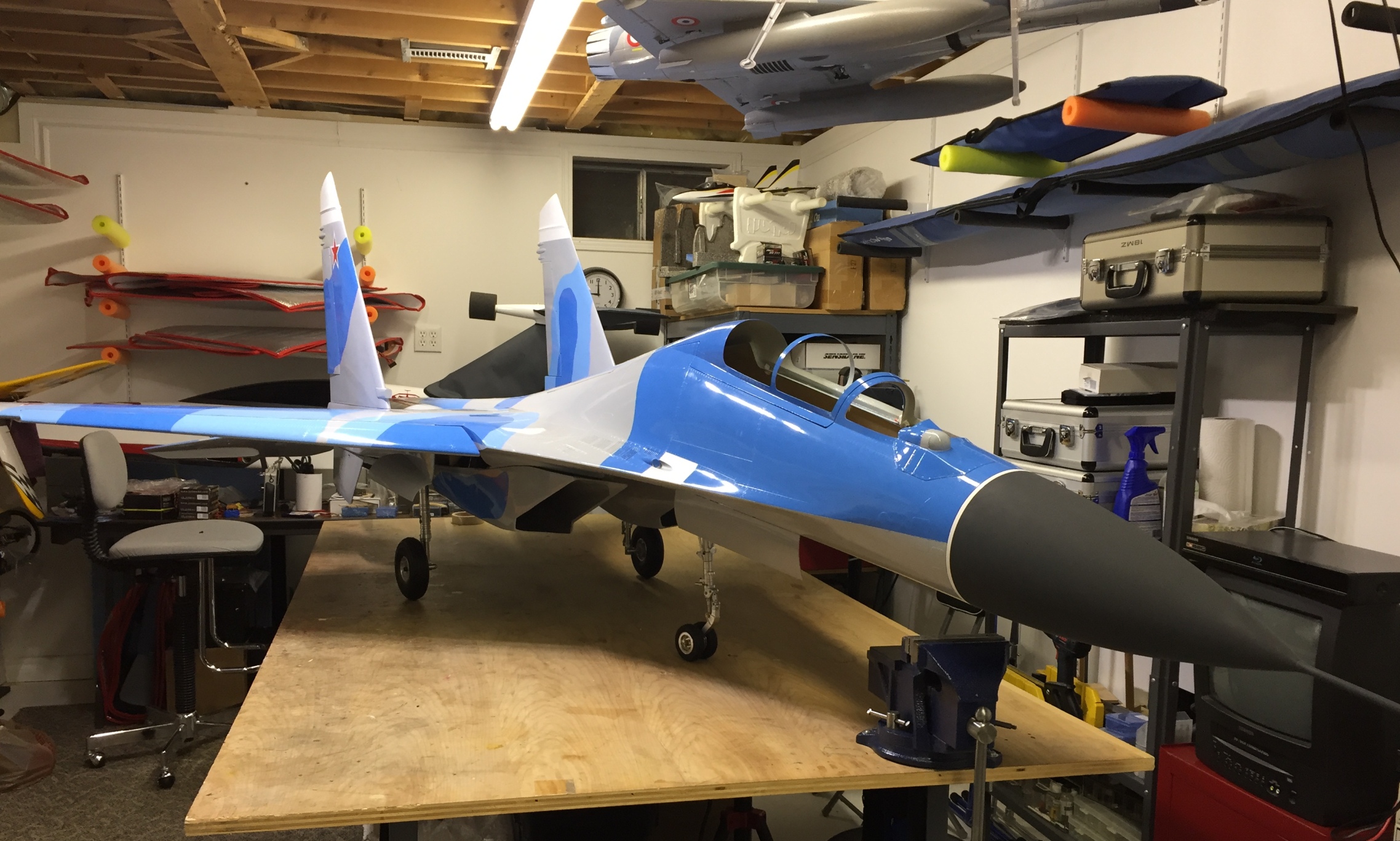

I have been following this thread for a while looking at the beautiful color schemes and paint progress as well as the test flight reports.
I am almost done mine. Still have to plumb the tanks, I had JetTech make an add on tank to have another 2L (well effective volume is really 1.8).
This kit does not come together smoothly, there are lots of issues with the left and right mold halves (not sure if CARF fixed that). Have to be very patient to build it since the instructions call for certain size control arms which work on one side but not the other. One of the stab carbon rods was not even in diameter across the length so there was lots of play, I cut the area and made a sleeve, also the main wheels purchased are absolutely terrible quality so upgraded to Behotec wheels and brakes. Main landing gear fit was an issue as well to make sure they fit properly on the rails and clear the skin and lots more small issues like that which pile up as you go along. Bottom line with patience you will get there.
Here are some photos and a video of the progress.
