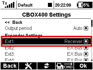

If somebody would like to test Beta V1.09 Jeti Central Box 400 firmware for 3x Receiver (2x 2.4GHz/1x 900MHz) Integration please contact me at <a href="mailto:[email protected]">[email protected] m</a><br /><br />Zb/Jeti USA<br /><br /><strong><em>Version 1.09 (October 2017)</em></strong><br />- Added input for 3rd receiver. It supports only EX Bus protocol and is available on Ext1. Primarily is used for 900 MHz receiver.<br />- Ext1 has following options: Expander, EX Bus, Receiver<br />For activation 3rd input for receiver is necessary reconfigure Ext1 to “Receiver” option.<br />For correct function is necessary to update file CBOX400.bin in transmitter’s file Devices
