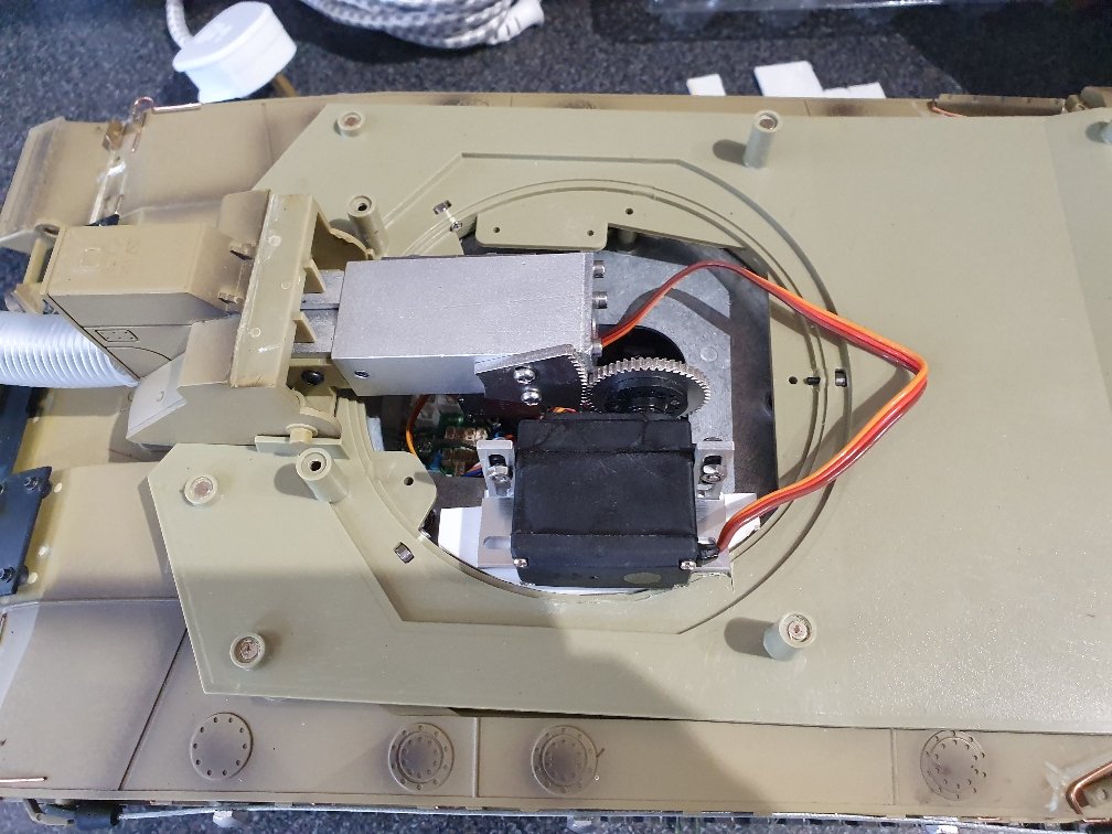

With her running nicely it's time to start getting the turret functions sorted. The recoil unit had already been fitted, it.just required some tweaking to roll smoothly. The elevation unit required a small platform to be made from styrene and a tiny bit of the turret to be cut away for it to fit nicely.
There were some issues with the elevation servo being faulty causing some odd behaviour but now rectified.
I really love how theres so much space in the turret. The tk60 I fitted is the g2 version with the GBS. I'm still not 100% sure how I'll wire it up but theres definitely enough room to fit the tk60g2 in here. Click image for larger version
