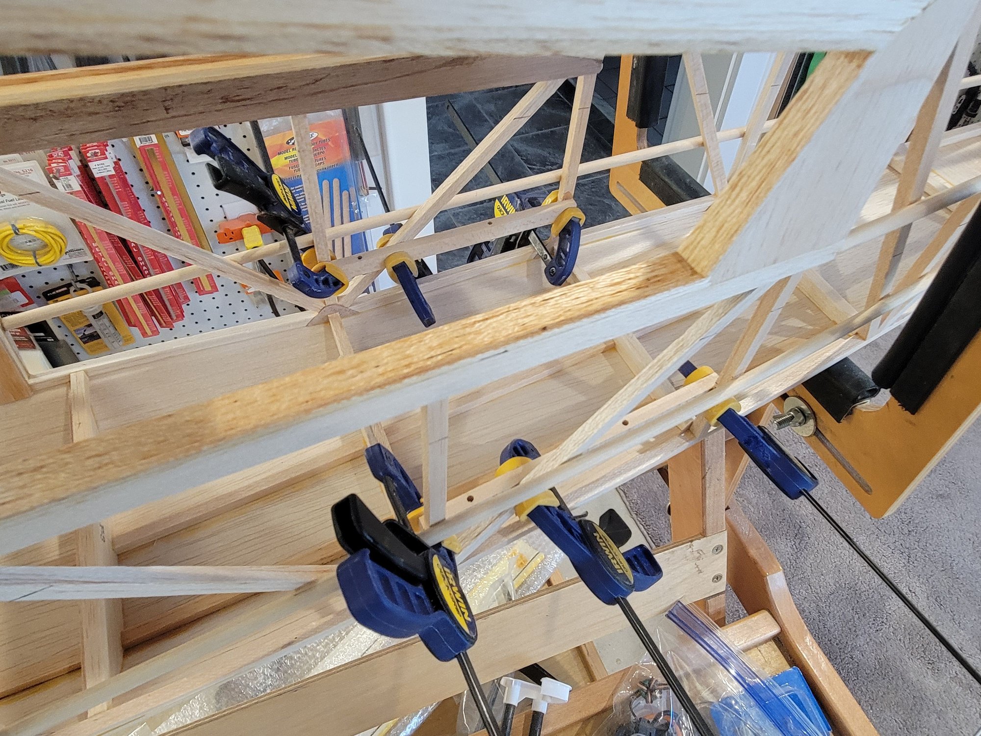

I made two servo tray rails from 1/4" x 3/8" hardwood. These will be epoxied to the sides of the fuselage allowing the servo tray to be removable. Four 2-56 blind nuts were epoxied into place.
Pro tip- Before epoxying blind nuts in place, always and I mean always run a tap through each blind nut. You don't want the headache of finding out the blind nut won't allow the fastener to thread correctly.
Servo tray rails epoxied in place.

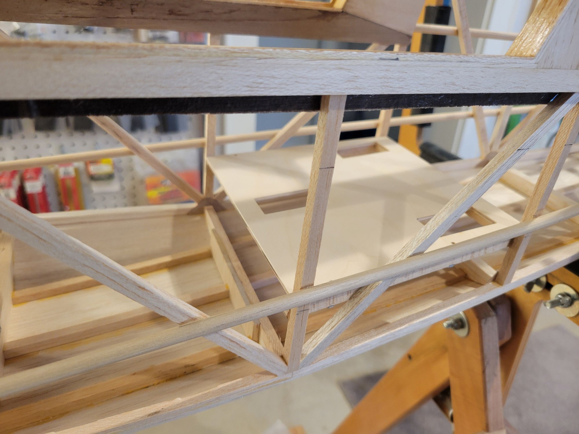

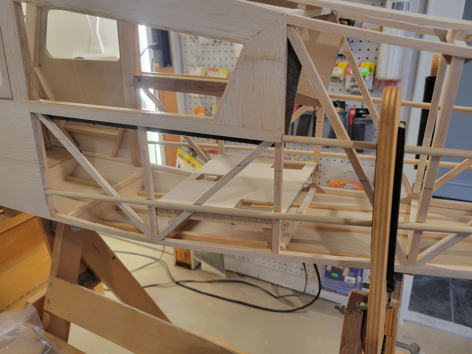

Servo tray fitted to hold three servos, the two aft openings will house the left and right elevator servos, while the front opening will be the pull-pull servo for rudder control.
