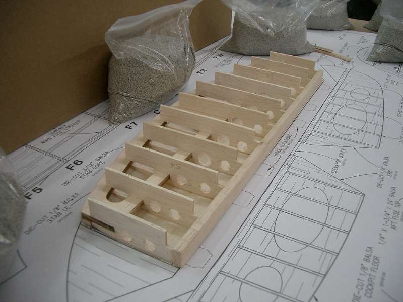

i'm just starting a TF Spitfire and thought i would try to post the build. i'm thinking of using either an OS91FS or RCV90, flaps, and CJ retracts. this will be the first time for flaps and pneumatic retracts. i'm going to try to modify the kit somewhat to try to get a better scale MkIX.
here is what i have so far. i added a few more lightening holes in the horizontal stab ribs . the tail section seems very overbuilt. i'm adding lightness where i can but it still feels pretty heavy. i think TF has heard the complaints about the Spitfire being so tail heavy because they have increased the size of the holes they are putting in the stab/elevators. however, they are using 3/32" balsa for the stab/fin ribs which i think would be sufficient with 1/16" ribs and sheeting.
