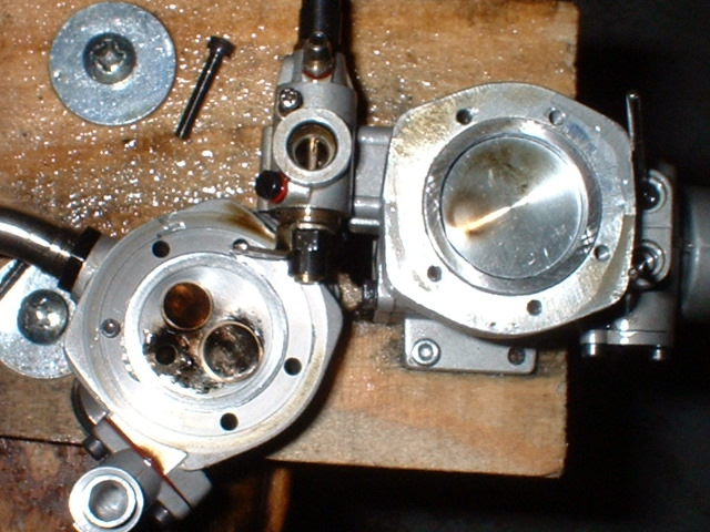

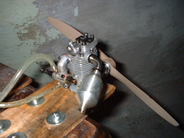

Today i am ready (not complete) with my Magnum XL 52 fourstroke. Has converted the engine to dieselengine.
And i has mixed new 4 stroke dieselfuel, i has never runned engine with glow or methanol/oil/nitro. Only new engine, then i slaughted [>:] new unused engine and maked engine to be a dieselengine. [8D]
Engine has Lanova combustion camber with contrapiston, all works well, not much carbon cause rich fuel while break in.

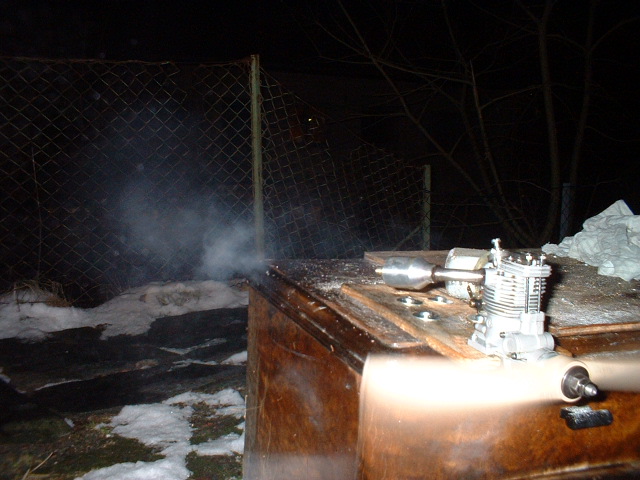

Now i am breaking in the engine, it ran without problem in cold weather -1 celsius (can not fahrenheit temperature).
Dieselfuel formula: 32 % ether, 10% castoroil, 10% 20W50 full synthetic motorcycle 4 stroke motoroil, 48% diesel (not kerosene, because diesel has better lubrication perfomance). Also i has all 3 things to lubricate engine: Diesel (we use diesel to lubricate dieselpumps in our cars), castoroil, 20W50 full synthetic motorcycle 4 stroke motoroil.
