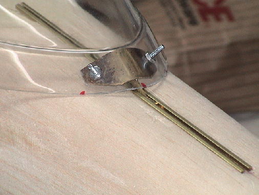

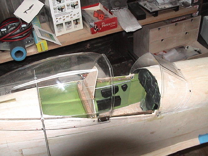

I faked everything. Tracks are from two pcs of 'c' rail soldered to a pc of flat stock, and the slider is a c-rail with another pc of flat stock, ground down into a tab that slides in the 'track'
Here's a photo or two:
