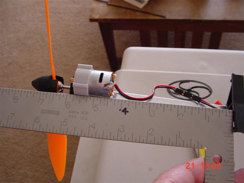

Pic # 1 Power plant and gearbox - Strip down the gearbox remove everything. Tape the front 2 triangular holes below the motor mount fill them in with Epoxy (will save you a gearbox or two).Bolt the motor on- shown is a 4-40 screw with a Nyloc nut. Have not done the "Prop Saver mod" search the net for this " Slow Stick Prop Saver". I also have a 5" strip of Industrial Velcro running underneath the tube - will explain.
