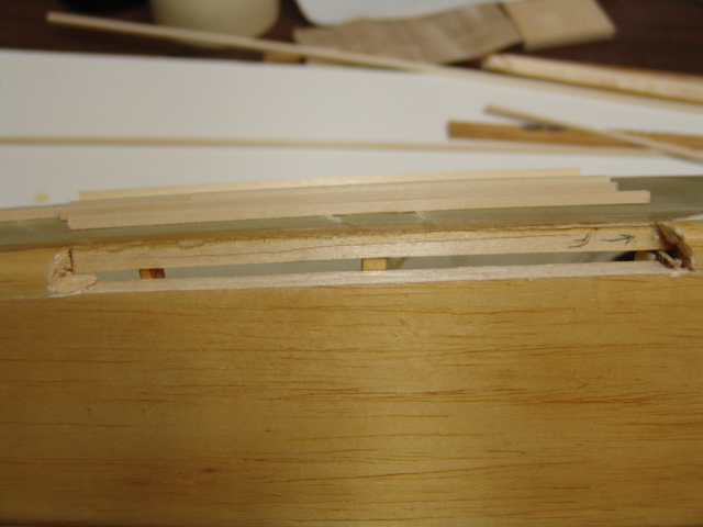

Next I used spots of CA to glue 1/8” square strips of bass wood on the outside of the fuselage. The idea is to get the broken parts of fiberglass to line back up to the original shape. I pushed the glass pieces outward from inside to fuselage to get them to line up on the hardwood strips. You can see in the angle image that they lined up pretty well but not perfectly.
To be continued..
