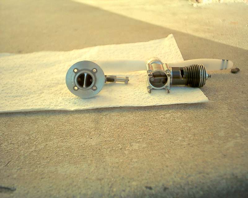

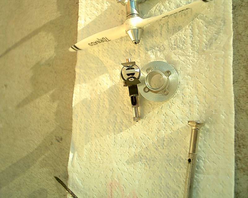

Japanman started the V block reedy thread a year or so ago. Posted that his was very effective, but didn't have a tach to get any numbers off of it with. I tried the V reed block mod to the cox .049, with the AP carb on it. I wasn't too impressed with the power output, until I finally figured out that my 7 year 25% fuel was the problem. (Tried running my Norvel with it and had poor results also.) I haven't gotten back to it for many months. I do think there is some very good potential there. When it did idle down, it was way lower then my Norvel will idle.
Here are a couple of pics of it:
