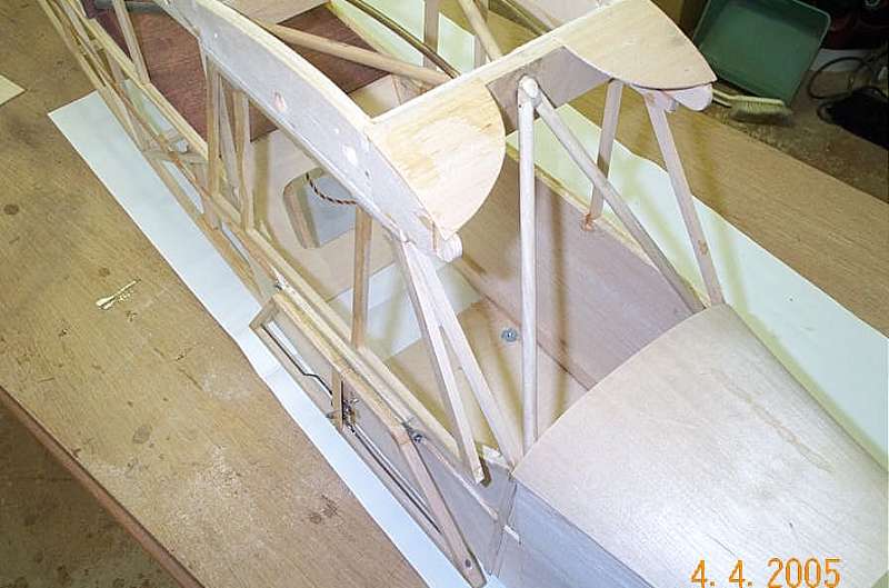

Here are some pics of my BUSA L-4 conversion. I have a photo pac and just used them and scratchbuilt the canopy. The BUSA uses sticks and I had to improvise a little but it will look good when it is done. The dowel in the pics is 3/8 and structural. The ends of the dowel are mitered and tapped and threaded together with 4-40 rod and then epoxied and tied into the main structure. The whole thing is solid. Even with this, the struts will be functional and mandatory. Any questions, let me know.
Warren
