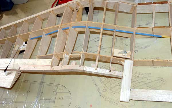

Aileron linkage completed
1: Sullivan cable running along main spar, connecting to bell crank. Control rod from bell crank to aileron control horn
2: Close up of bell crank assembly
3: Routing of Sullivan cable
Note that the remaining trailing edge of the wing has been cut out for the flaps. I think thats where I erred. I should have assembled the rib structure while it was still attached as Luke shows in his F2G thread.
