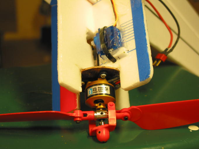

OK...just maidened my first EVP setup..
Using the Scott Foster EVP hub.
Axi 2208/34 motor
CC25 ESC (and Boyt it gets hot!)
TP 3S 1320mAh battery
and 4 hs-55 servos
Airframe is the Hobby Lobby Yas 55
It just doesn't have the WOW factor
I tried to set max pitch so when it is spinning the system doesn't exceed 8amps on my watt meter...
but that is barely enough to hover and NO WAY enough for reverse flight....
it slows down a bit on down lines...but no reverse
AUW with Everything is about 11.5 ounces
Attached is a picture of the setup...
any feedback??
I am using the 9C radio and I have it set up to use the Governer mode with Idle1 and normal...
Any input????
