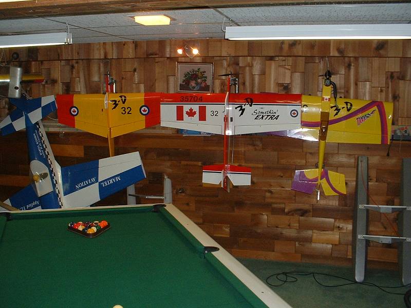

Oops, forgot to add, Yes Ed, that's a Sirex Wasp in my avatar. I flew that for 3 or 4 years but it died due to battery failure. Still have the Cad files and building instructions. Great little flyer. I've scratch built two other profile planes - here's a pix of my 3D wall...
