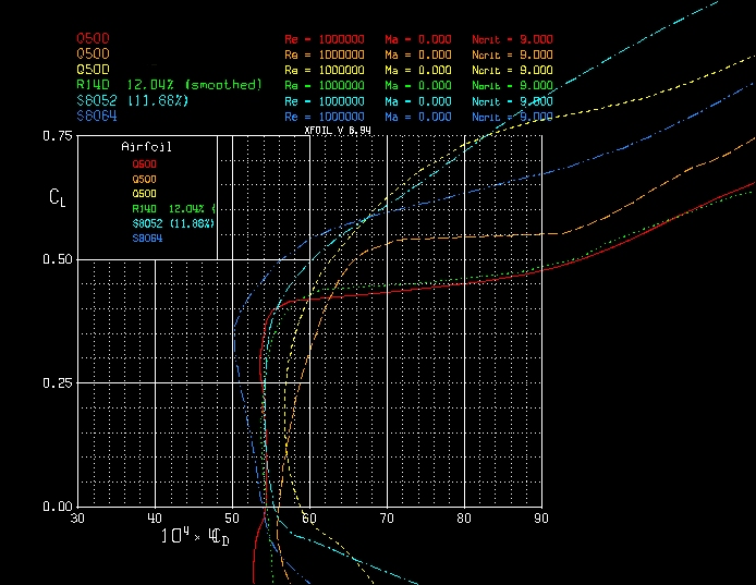

I've attached some XFOIL predictions that include the S8064, S8052 and some other Q500 airfoils from some airplanes that were/are popular. This comparison is by no means exhaustive. For a lift range from 0 to ~.6, the S8064 is looking pretty good to me.
