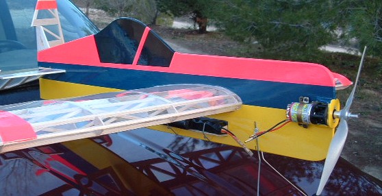

This is the Sukhoi I printed the plans for off the net. It was suppose to be built from 6mm foam. I do not have any so I just used balsa. The fuse is built up and sheeted. Span is 44 inches and as you see it, it weighs in at 44 oz. It weighs 13 3/8oz without any battery, motor/gearbox.
It is powered with a 10 cell 2400 nicd, Magnetic Mayhem, gd600 gearbox turning a APC "E" prop. I am not sure of the servos I should use. The HS-81MG's maybe to heavy and the HS-55's might not have the power to move the surfaces.

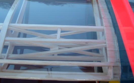

here is a close up of the wing.
