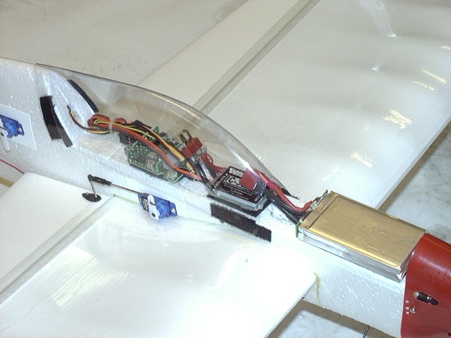

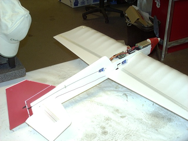

I am almost finished with my wattage live wire. I used Hitec HC 55 servos, a Kokam 2s 1500 battery, wattage 30 A esc, and JR r700 reciever with the case off. I modified the tail so it is not all-flying, and used better hinges. On a digital scale it weighs .926 pounds or 14.82 oz. Here is a pic:
My problem is that the battery is too big for the canopy parts. I know other people are using that battery, so what are you guys doing on the canopy?

Ok, I came up with something. I put velcro on the clear canopy so it covers the reciever and esc area. The battery just has to stay out in the breeze. I flew it yesterday, and was disappointed in the performance. My Aerobird had more power than this toad.

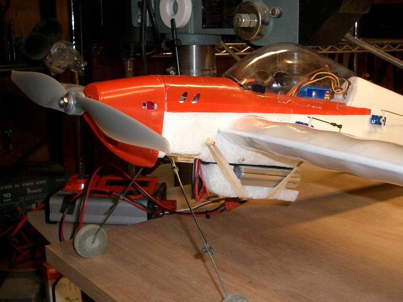

I used a Thunder Power 3 cell 2100 mAhr cell along with a Hacker B12 15L with a 4:1 gear box and a 11x5.5 prop on my Live wire. You had a good idea to make the rudder non-all flying I will do that also. With the stock rudder when I go to full throttle the rudder flaps back and forth. Anyway, I ended up hanging the battery underneath the wing near the CG using velcro and rubber bands. Sorry I don't have a picture handy. I also made a foam faring to protect the battery on my less than perfect landings. Anyway, this setup has plenty of power. All it took was adding a $300 power train to this little foam airplane! Lots of fun.

As for my landing gear it is just 1/16" piano wire and foam wheels. Longer gear was needed to accommodate the longer prop. At first the gear was too floppy and the plane would hit its belly unless I landed perfectly (something I still don't do every time) so it is re-inforced with more wire and zip ties. You can tell I don't have a lot of time to dedicate to making my planes look great.
