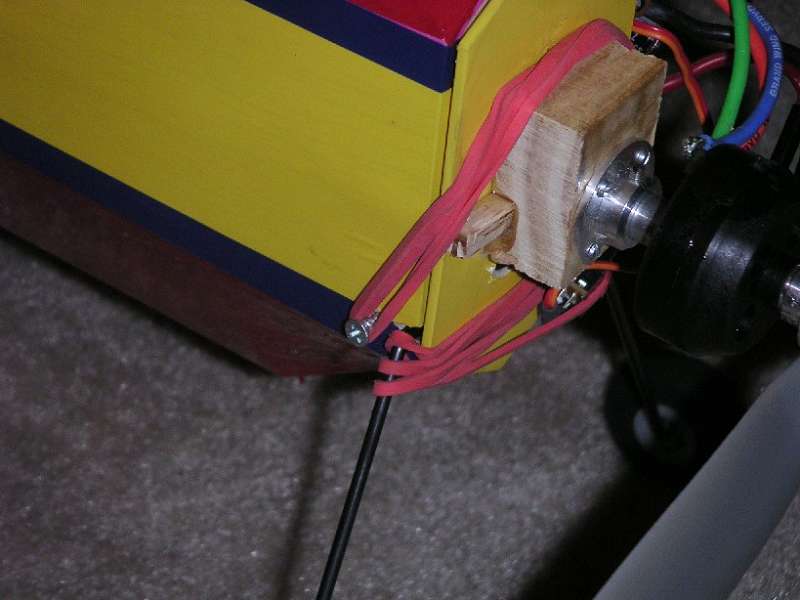

Here is a picture of my motor setup. The battery goes inside the little drawer where the fuel tank was supposed to go. I run the battery lead through a hole in the firewall and connect it to the speed control which is velcro-ed to the outside. I use two rubber bands to secure the drawer. One is looped around the LG, the other around two screws in the LG wood block. I cut down the wooden motor mounts and glued a small piece of pine to the firewall and what was left of the wooden motor mounts. I then screwed my PJS motor mount into that. This provided a more solid base to screw into and also helped move the CG forward slightly.
The CG is probably a little too far back since this setup is SO light. However, it will fly inverted hands-off and almost hovers itself. You have to really try to make this thing stall since it's so light. It seemed to handle a light breeze yesterday very well. It has the best roll-rate of any non-Zagi plane I've flown. I can't say enough about this thing.

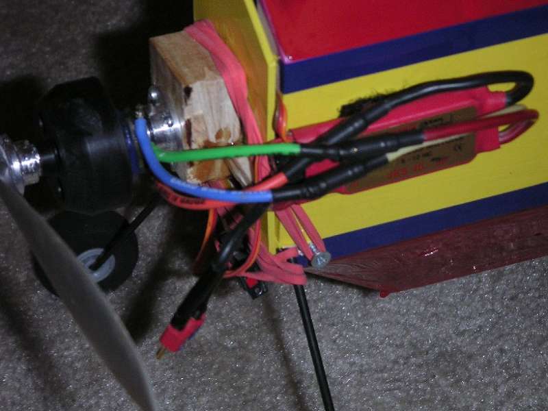

Picture of the speed control. I would like to place the speed control inside the fuse, but I couldn't get it to fit very easily. Also, when you open the drawer to get to the battery compartment, it's easier when the speed control and be removed. The speed control being on the ouside keeps it cool as well.
