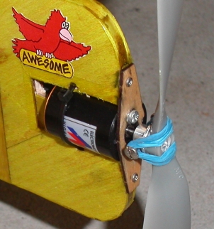

The AUW of my Attitude is 19.5oz
Mega 16/15/8 DD
APC 12x3.8
3S TP 2100 / 3S Tanic 2200
She can hover at 50-60% throttle and flight time is about 20 minutes
