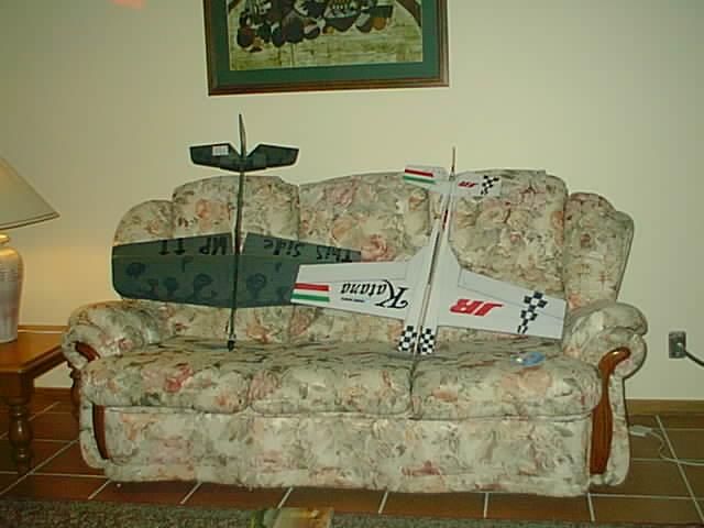

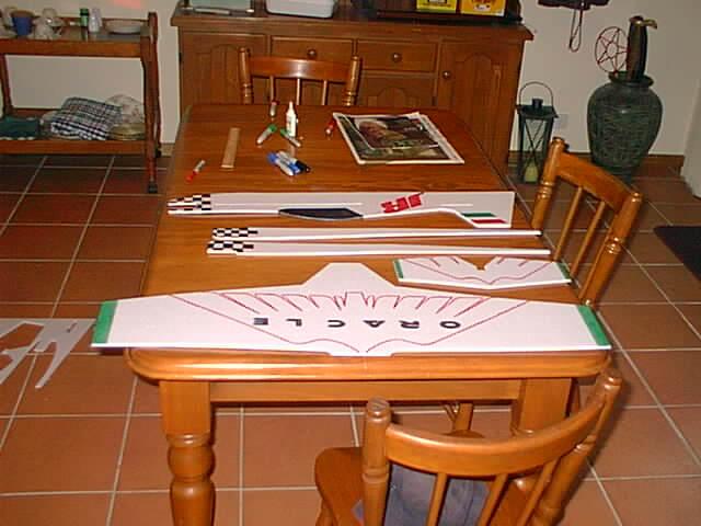

i am also building the katana. myne is slightly modified (shorter wing span bigger control surfaces and taller fuse) and it will be running an AXI 2212/34 (35 oz's of thrust) with only a 12 amp speed controler. this is wat it looks like so far:

chris-b-chips, that looks GREAT!! Did u use decals or paint or what?? Looks good man. Make sure u send pics to Levi

i am 12 years old. i am still flying the 3DX and it is awseome with the axi!!!! pulled the elevator off last week when i pulled out of a hover. it has ballistic power and only a 12 amp speedo. the coulor scheme is done with permanent markers like all my foamy models. i haven't gotten any further yet because i'm waiting on the servos until i can start.

looks good. I built one and flew it for about a month and just trash canned it recently. It is a nice looking foamy but it will need WAY bigger elevators and a bigger rudder. I added an inch on the back of the elevators and an inch on the end tips and it still wasnt quite as effective as my jeff williams e extra or e sledge. I also added 1" on to the back end of the rudder. After that it 3d'd pretty well IMO/
In these designs it doesnt take much at all to break the fuselage at the back just forward of the stab, mine must have been broken there 3 times and glued back together before I added a short length of CF tube along the back to help this out. flirting with the ground and wingtip hits will do them in pretty quick. Next time try a jeff williams design E yak or E sledge. they are WAY better just my opinion
