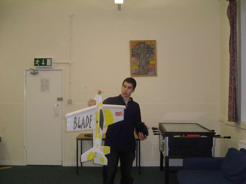

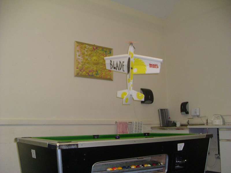

Personally i hate mine! it sucks at normal flight. it flaps its wings like a ornithopter! Actually it looks like steins avatar!!
so i'll gat a Ikarus Yak when mine dies untill then ill just have to hover it round my room.
