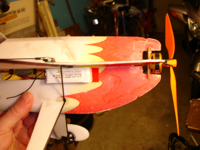

When mounting an AXI, does anyone put down thrust in their motor mounts? How about right thrust?

I mounted all mine dead straight.

just mount it straight.

all of mine have needed some down thrust to get them perfect .. and it ended up with a little rigt as well .. put the mount on strait and then later if you feel you need it use some washers and put them behind the mounting bracket

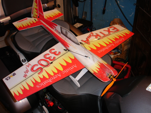

Could some one post a pic of how they mount an Axi on a Shockflyer.

Hi!
Her is some pictures on my Shocky with smallest AXI motor (25g) and 8x4,3 GWS prop.
Weight is 150g.
on 3cell E-tec 450mAh Lipo its a rocket!
Regards!
Jan K
Sweden
