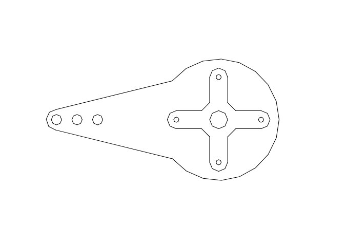

Does someone know where I can get longer arms for HS-55 servos. I need more theow on my rudder. Thanks

There are several methods to achieve a longer servo arm for the HS-55's. One way that is very easy is to make an extension (as long as you need) out of 1/16" birch ply.
Make it large enough in the center to fit over the standard X-arm that comes with the servo and then extend the arm portion to the required length. Be sure to drill a hole in the center so you can attach the arm back on to the servo once your assembly is complete. You can attach the ply to the X-arm with epoxy or medium CA. Just keep the glue out of the center hole.
A picture is worth a thousand words. Hope this helps!

Thanks Push Rodz that is what I was looking for. Thanks

Just remember not to make the arms too long.......as the HS-55 will only handle so much torque and then it max's out.
