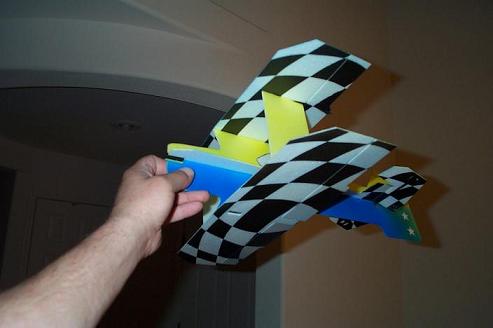

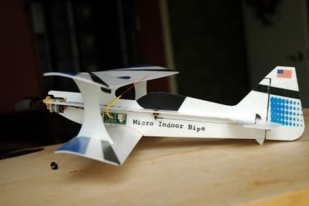

In the small stuff, you have to start somewhere and here is a good one to get your feet wet.
Here's are a couple of pictures of Littlebirdz Indoor Ultimate Bipe.
I purchased the kit from Mike at Eflightdesigns.com
The decals are installed a bit different from normal decals, using Minwax Polycrylic but went well by just following the well written instructions.
Mine weighs out at 27.6g due to careful building techniques.
This one flys sweet!
It flys nice & stable and also slows down very nicely. It will do loops & some minor acrobatics.
Ok, OK. so its not a 3D blow your mind plane but if you want to try the small stuff this is a good choice.
Lots of fun!
12.75" WS
11" Long
1 - 210 mA Lipoly
Kenway M-20 w/4.2:1 gearbox
GWS 5030 Prop

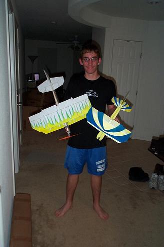

The 75% and 50% Tensors (20" ws & 14" ws)... The 75% has a build-up fuselage with the electronics located inside; makes a very light and strong (rigid) fuselage.
