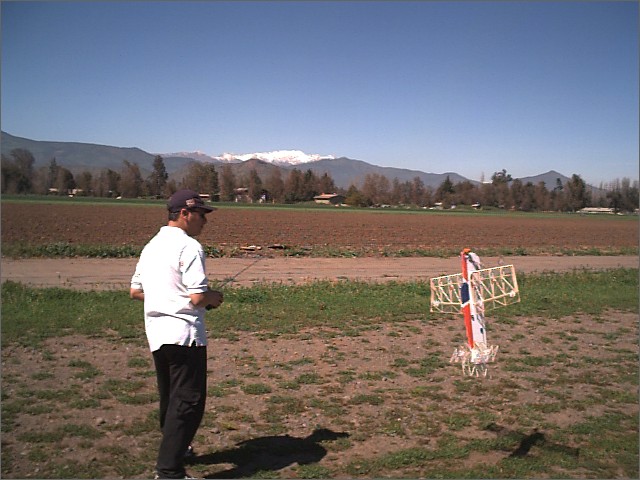

I have a 9.2 oz plane on a gws 350c DX 1200 2s etecs, do you think that this is the way to upgrade?, I asume that my lipos wont be usefull
I`m thinking about to stick to this weight class planes or go for a little bigger (heavier plane), say 13 oz, either way the prices of BP products are by far better of competition, need your recomendation for both alternatives

DanielZ, it depends on how much weight you can shave off that plane. If you can get it down to 7-8oz, it would probably fly pretty good on the 2cells. If its gonna stay at 9.2...Id go for a 3cell.
