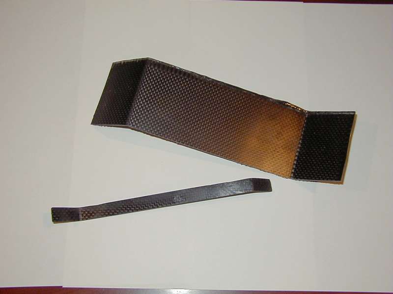

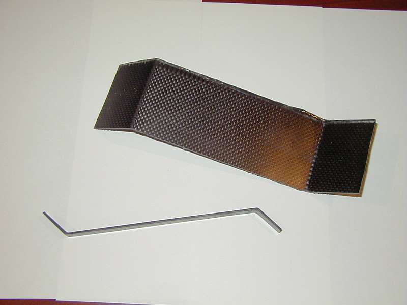

Thanks for the heads up Wazmo. I ordered a SU-26 "Pro" Kit from [link=http://www.rcairworks.com/]www.rcairworks.com[/link] yesterday. I'll see what they have in the kit. I've built some CF landing gear for these planes but dont have a scale to weigh them. Any idea where I could get something? This is my first build so still on a bit of a learning curve. Thanks in advance for your help.
