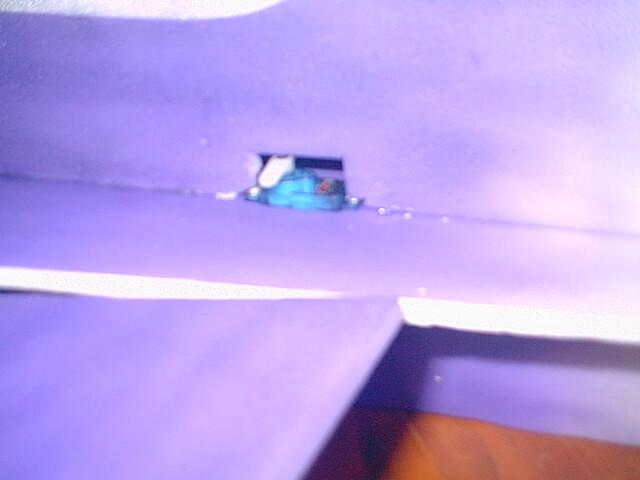

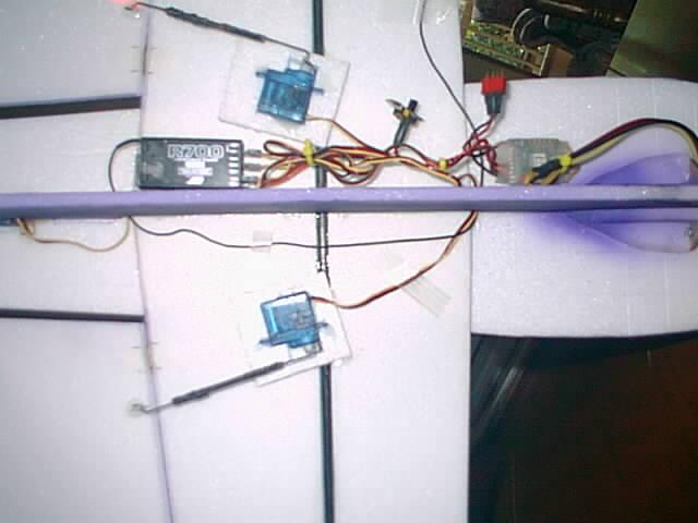

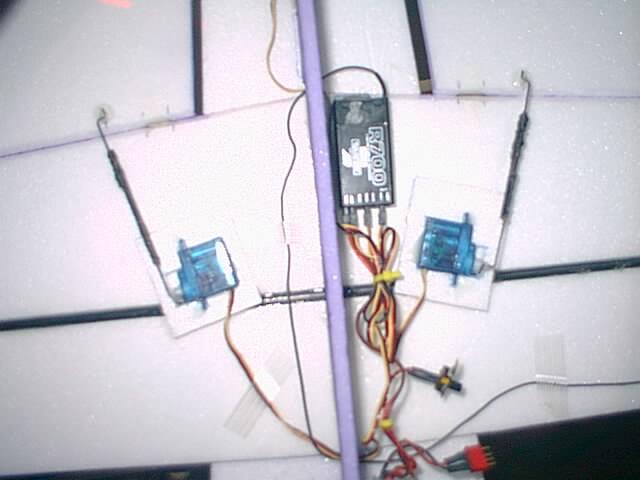

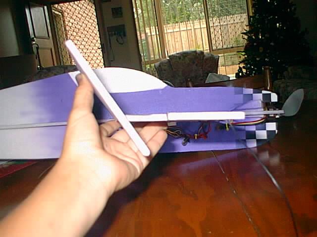

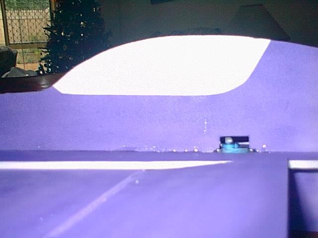

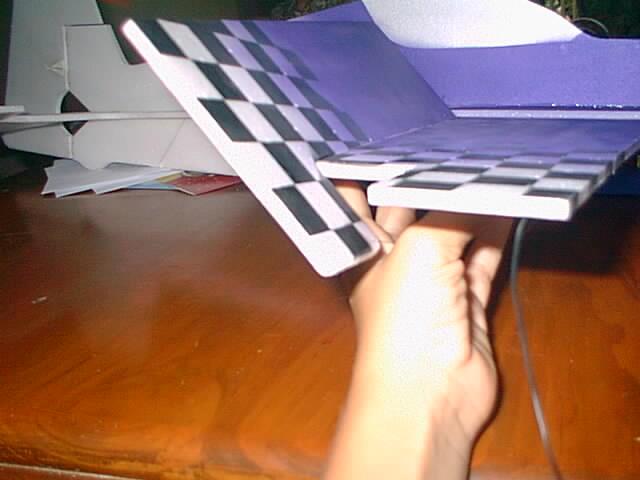

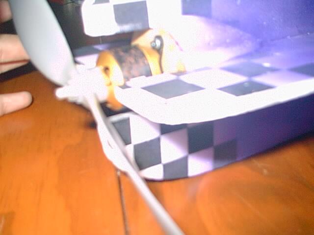

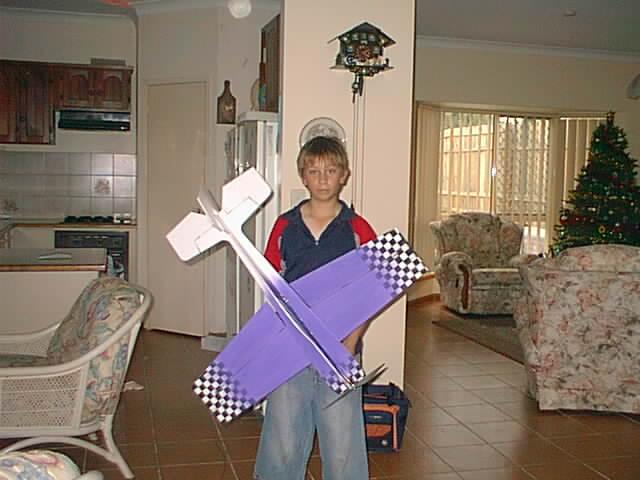

Hey guys and gals,
I've almost finished my 3DBatix extra and i have to say im impressed! this plane just "looks right". im guessing its going to fly insane! I would normaly design my own foamy but this design just about had evrything i was looking for so why go through all the effort of drawing up plans. i made a few mods to get it to my likings ( bigger COUNTERBALANCED ailerons , slightly bigger elevator and bigger rudder). this was my first attempt at airbrushing so dont scrutinize it to much! Power setup is as follows:
-HS-55's all round (i'm yet to find a better servo!)
-Trusty old AXI 2212/34
-rclithiumpower.com 3s 830mah battery
-JR R700 reciver ( yea its a bit heavy but i dont have the money for a micro rec)
I've found this to be the ultimate setup with my foamies. i've attached some photos of the plane and a mug shot of plane and pilot I'll get some video this weekend when i fly it.
So who else has had experiences with this foamy?????

wow chris amazing plane pls post a vid. is that you whos holding the plane. it pretty cool how young kids are starting to get involved. like me in only 13 and crshed a coupls of times but worth it if you want to be better. thats a really cool plane btw.

Hey mountaindr3wz
Yeah thats me, i'm 14 [X(] and i've been flying for 4 years. great to see that i'm not the only younger pilot out there!
Thanks for the kind comments,
BTW,
It flew today, and boy did it fly!!!! easily the best foamy i've ever flown so i'll cut another one out just for backup! unfortunatly no vid, the elevator pull-pull cable snapped before the second flight so no vid[] but i'll deffinately get some next time i take it out.

Cool plane. I like the paintjob, it looks good. 6mm foam...I like that too. Looks like it would be a really good outdoor 3D foamy.

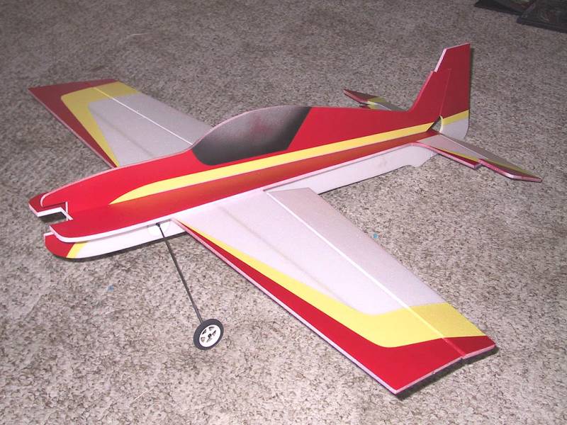

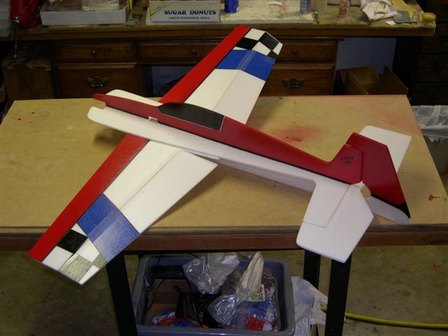

Looks good! I just finished putting one together for when my 3dbatix Diablo dies. The Diablo is an awesome foamy and the Extra is supposed to be even better.

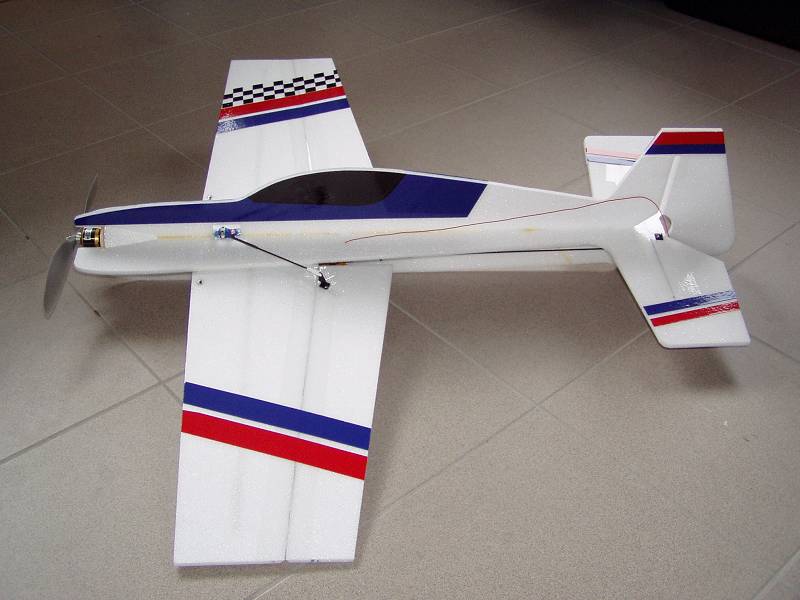

Hi,
I've made a 3Dbatix diablo, extra, and a foame2x. All planes fly great, only the 2x is much harder to fly when CG is set back. It'll knife edge without rudder assistance (I mean: it won't turn on ailerons only).
Something I have to say though: the Axi 2212/34 is an excellent motor, but next time I'll have a 2208/34 to power the plane. It's a littlebit lighter, and has more than enough power.
In general, the Batixplanes are a tad heavy, 6mm foam and the big axi make quite a load at the end.
I plan on building a new extra, with all the weight saving I can get. The axi2212 lets the planes hover at half throttle, this means the planes are really overpowered.
Getting the wing load down will allow for a lighter motor, and will have a positive affect on slow flight properties. I will probably also integrate airbrakes to increase airflow over the control surfaces. (slow flight with forced air (from the prop) passing over the controls gives much better reactivity).
I also like nice painting or decals on a plane, but they increase the weight more than you think.
I love my 3Dbatix planes!
greetz.

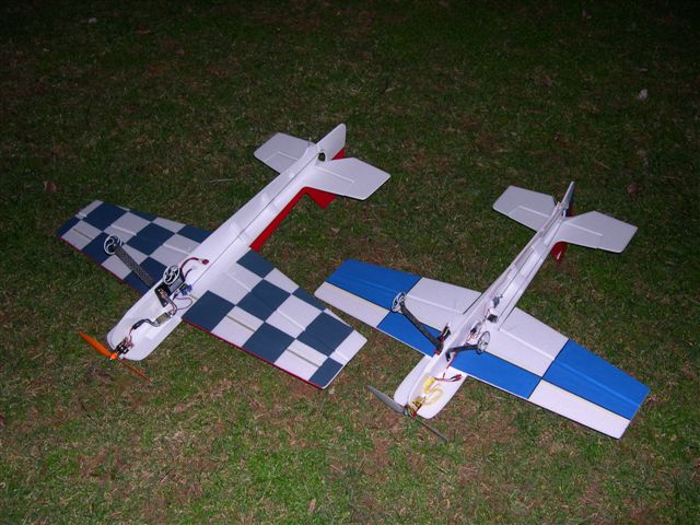

got some pics too...

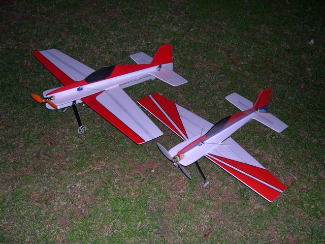

Yes they fly great. So far I have built 3 all out of 6mm Depron. A 34" and 2 39". I plan to build a new 34" out of 3mm Depron and keep it light and it should be bettter than the 6mm version.
