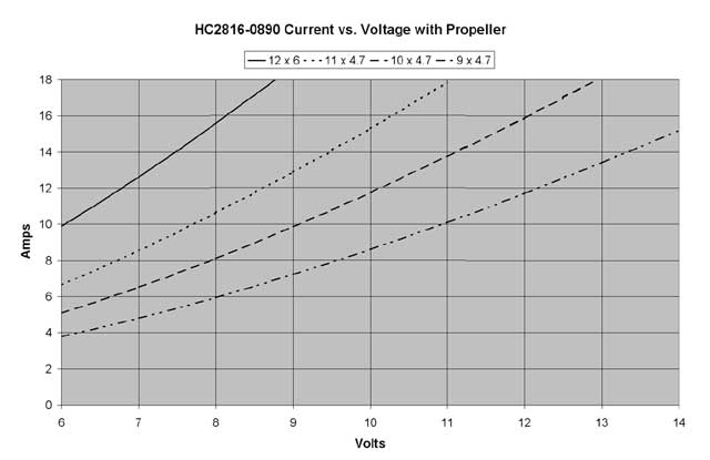

Another motor I am picking up tomorrow is the HiMax 2816-0890... it too calcs out to 150+ watts with a 12x6 on 3cell. It weighs about .6 oz heavier than the Hacker and runs about the same price... $70 or so. Why would I try it? Because I want to compare them and what MotoCalc says.
HiMax motor manuals offer some real good info... see the attached. You scan across the bottom till you find the voltage you put out (10 with 3 cell) and go up till you cross the dotted lines that represent the props sizes. Then stop at the one that crosses the 10 volt line last. In this case it's the 11x4.7 at about 15.3 amps.
Watts is calculated by multiplying volts and amps 10 volts time 15.3amps = 153 watts... very good for a 1lb plane.

As emnm79 mentions, the Park 450 outrunner is a 12x6 motor, at least from the calcs and my personal experience with it. A good practice is to have a couple of each sie from say 10x3.8 to 12x6... hook up the wattmeter and check rpms.
Try the 12x6... you'll draw close to 17 amps and SHOULD drop to around 9.6 volts... 163.2 watts per lb. Very nice for that plane... If you are only drawing 13 amps now and dropping to 9.8 you are running 127.4 watts... Still decent but noticeably less power than the 12x6.
