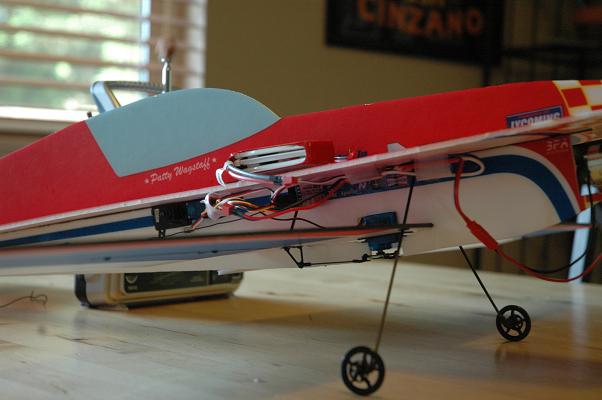

Just got done with my Great Planes Flat out ARF... This was my first foamy, it was pretty easy except for the small plastic pieces. I had to do some improvising but it seems to have worked... Now i am just waiting for the wind to die down for my maiden flight... I hope it goes well... Here are a couple of pics.

Looks like you did a fine job. My Flatout was a hassle as well with the hinges. I finally used tape for the control surfaces.

Well i just flew it... It was a little windy but i had a crowd so i had to... I need to turn down the servo rates the thing was crazy... I had 2 great landings and 2 crashes... Only a little crack but nothing that cant be fixed... BTW how do you turn down the rates?

If you have a computer transmitter you should add -50% expo. (notice this is a negative number) You can also adjust the end point of travel, make sure you adjust both left and right (up and down) the same. They are independently adjustable.
If you do not have a computer transmitter, move the servo connections in closer to the servo, and move the connections on the surfaces farther away from the surfaces. This changes the mechanical linkages, so 30% on the servo does not produce the same deflection on the surface.
