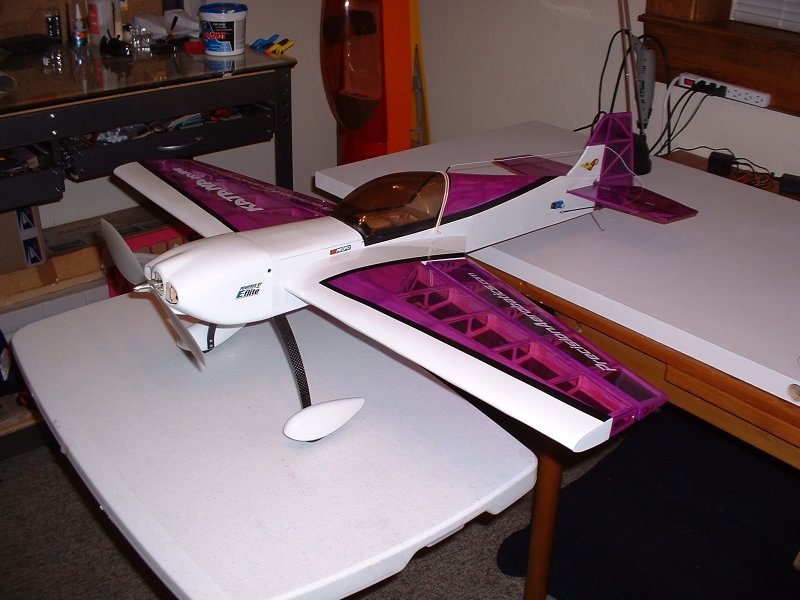

I flew my Katana Mini for the first time this weekend. Everything is set up per the book but it wants to climb with power so I trimmed it out and moved the CG forward.
The biggest problem is that as soon as I cut the power for landing it snaps. I have a lot of airplanes including a 25% Cap 232 and have never seen an airplane so snappy.
Right now the thing is unflyable.
Anyone have experience with this and is there a recommend fix?

Check the lateral balance as suggested. Also, add a ton of expo to the elevator. The elevator is very poertful and can cause the plane to snap if you apply alot of up when near the stall speed.

Mine is very stable at low speeds. I land with just a small amount of throttle. I suspect your engine incidence is wrong. If it climbs with power it might have up incidence. I set my CG so it flies hands off upside down. I fly with slight 1/16" spoilrons just to avoid wing rock in harriers.
First get the incidence correct. Test this by flying at mid power and trim it out, then fly at high power. The plane should track the same.
Next test CG, the inverted test is good, but you can also fly it high with mid power, then point the nose down to 45 degrees as the plane accelerates it should stay at 45 degrees. If it flattens out, you are nose heavy. If it dives, you are tail heavy.
Have faith, this is a good flying plane. stick with it.

I reduced the rates on the elevator from 65% on low rate to 40% and that cured the problem. However on the first flight the tabs that hold the hatch pulled out and the hatch and canopy flew off. I landed it perfectly and the right gear folded which caused the prop to hit the pavement tearing the motor out of the cage.
So now I have beefed the whole thing up by addiding a lot of 1/16 plywood.
If it breaks again, in the trash it goes.
It's a nice airplane but waaay too flimsy and who ever came up with the two piece landing gear wasn't thinking too well.
