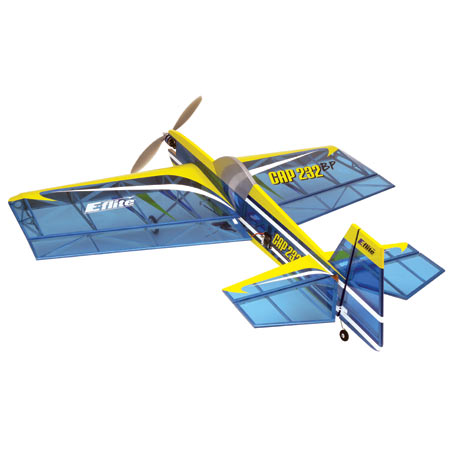

I would like to use one of them on the new Cap 232 BP ARF. I just cannot decide which one to go with.

Jack,the Hacker A20-20L is 1022KV compared to the E-FLite 450's of 890Kv,the Hacker would make that plane a rocket ship,depending on how long you have been flying 3D one thing i noticed was at 2-1 power to weight ratio and 3-1 and over(meaning way over powered) there was a big difference in controling it in a hover with the way over powered systems it's harder to control with so much power ,might want to try the A20-22L at 924KV if you wanted to go with a Hacker motor and not the E-Flite.In a nut shell the Hacker A20-20l would leave the 450 in the dust. IMO Olin

Go with the 450, power is good, but WAAAaAYYYYY too much power is never a good thing, especially when your going to try and hover and do other 3d stuff.

i have been convinced, thank you very much for your response. I will go with the hacker
